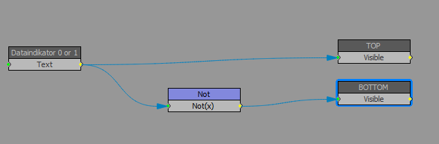

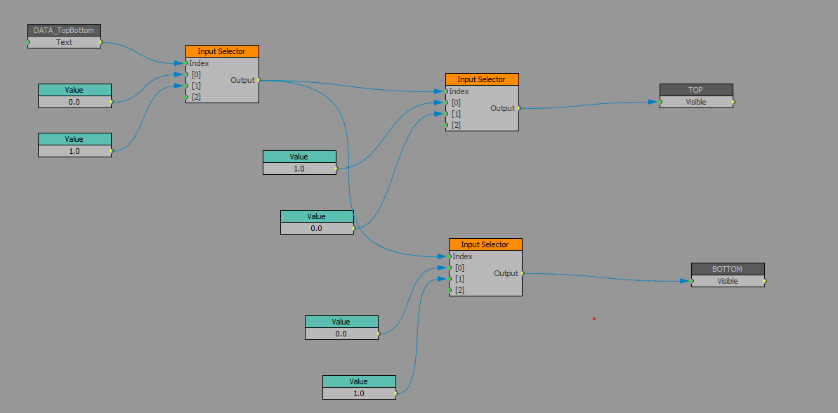

OK, give this one a try. It looks at a hidden data field that is either 0 or 1 (top, bottom). then uses logic to turn the top and bottom indicators on and off.

I definitely want to use visual logic. It's something I'm trying to learn and I use it for a few things already in my scorebug.

You can do this with either visual logic or by scripting. Both are pretty easy. Basically with a script it would look at the data point for top or bottom. Then it would run an if else argument and turn on or off the indicator. Let me know if that's the way you want to go, Either way, it's pretty straightforward. I'll set one up and let you see.

I am really new to visual logic and was wondering the best way to linq my top and bottom inning indicator. My data source shows a "0" if it is the bottom of the inning and a "1" if it is the topof the inning. Really appreciate some feedback this page has helped me out a lot! Thanks!
