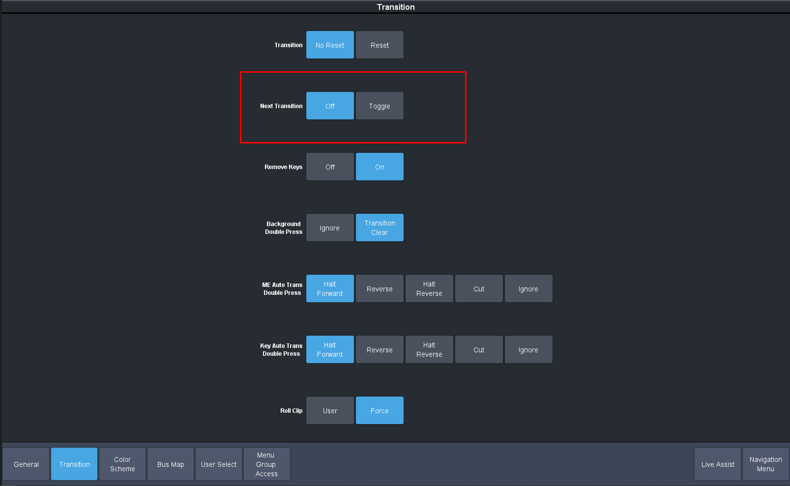

  • 2.  RE: Touchdrive Key buttons
    Posted 08-14-2023 09:38
    Hi Philip,
    In DashBoard head to the Personality Menu and on the Transition Tab you will find the culprit..
    It is probably set to Toggle.
