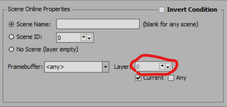

    I'm trying to create a scene with transition logic where it has a scene online condition. I would like to check if any scene is online on a certain layer and I assume i'd do that selecting a specific layer number on the scene online properties, but I can't for some reason change that value as it's greyed out. How could I adjust it if possible, and if not is there any other way to do this check?
    Here's what i'm trying to change

    Uncheck the box that says "Current"

    Make sure that neither the CURRENT or ANY checkboxes below the layer menu are selected. Then the input field will become operational.

    I didn't realize you could uncheck the boxes, thank you so much
