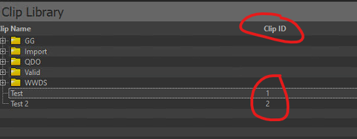

    im trying to build a Dashboard Panel to load Clips into my Channel of my Tria Server via VDCP.
    We have a daily Show with changing clips, which I want to trigger from my Dashboard.
    But i dont want to edit the file names every day, so I want to use the ClipID.
    The operator can quickly edit the Clip ID in the Clip Libary and the dasboard panel allways load ClipID 1,2,3 etc..
    I could only find the soultion, where I add the correct filename into the ogscript ClipID.
    Does it works with the ClipID?

    The Clip ID needs to be alphanumeric. Try using the ID CLIP1, CLIP2 or something similar.
