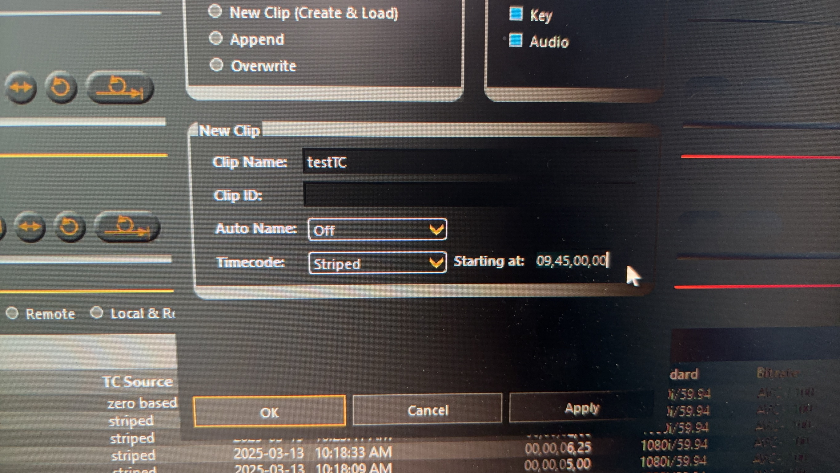

Hi Vic,
You can connect external LTC timecode to your Tria+ using the XLR connector on the back of the chassis. You'll be able to record with LTC in :
- External TC - First Frame Only - the clip uses the external timecode data of the first field/frame that was originally recorded with the clip. The timecode for the remainder of the clip is synthesized. This option is useful if there was a break or interruption in timecode data during recording.
- External TC - Entire Clip Length - the clip uses the external timecode data that was originally recorded with the clip. This option is useful if the clip has different segments in it with different timecode ranges that you want to use.
Make sure to setup the timecode option in the Tria Config app : https://help.rossvideo.com/tria/Tasks/Setup/Server/Timecode-Setup_Mira.html
Once you have Timecode in Tria, you can trigger a record command from Dashboard if needed.

From: Vic WANG
Subject: Tria+ write timecode and timecode external tc Starting on first frame
I would like to ask Abekas Tria+ how to use ogstript video recording to write timecode and timecode external tc Starting on first frame.
Thank you
