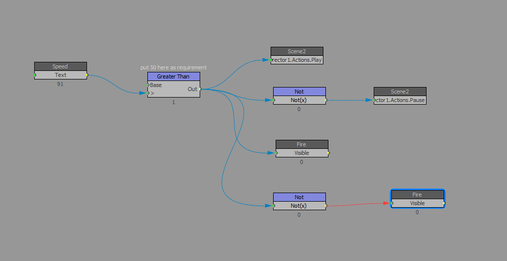

  • 14.  RE: Triggering a different scene with Script
    Posted 06-01-2022 12:16
    You could probably just have something like this.
  • 15.  RE: Triggering a different scene with Script
    Posted 06-01-2022 23:36
    I sent her this script to play with.
    dim sd as xpSceneDirector
    if text > 89 then
    scene.GetSceneDirectorByName("fire", sd)
    sd.PlayRange(0,100)
    end if
    Malcolm Thorpe
