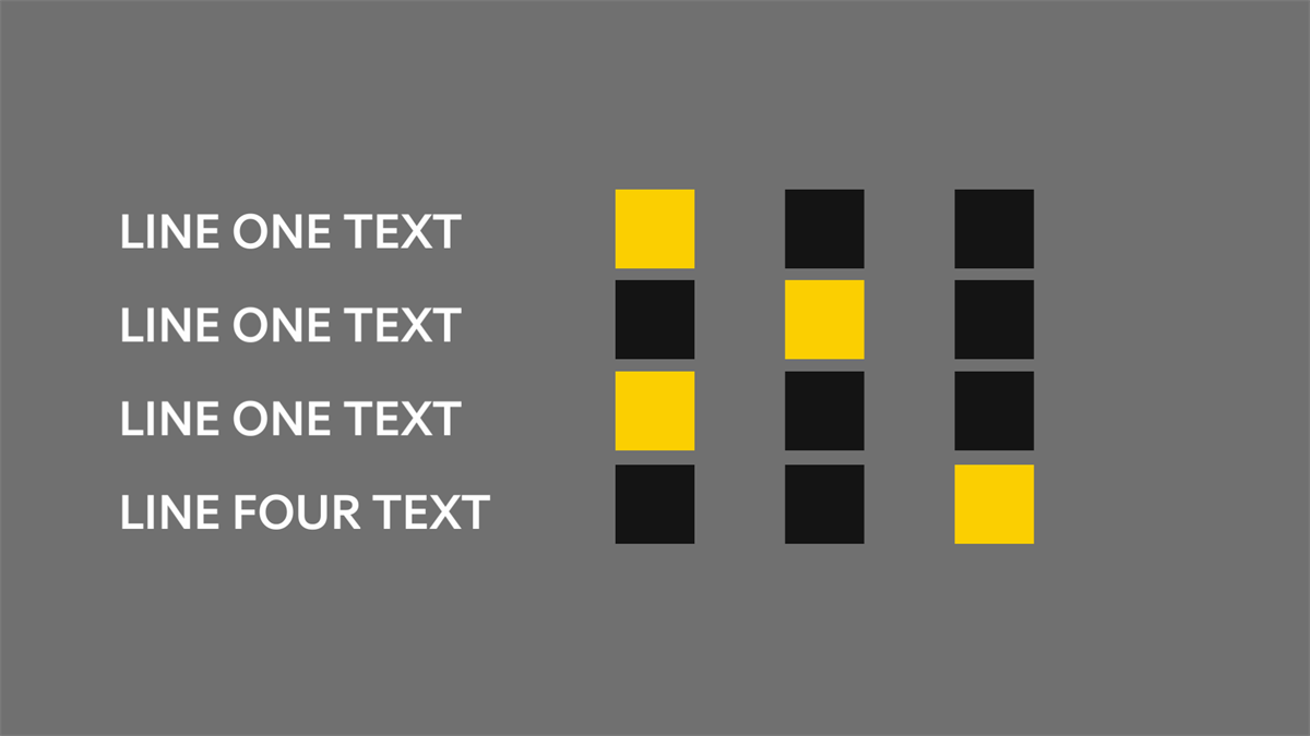

    Hello all.  My question involves choosing an animation to play out "on the fly" while the graphic is online.  I begin by playing out a full screen.  There are four lines (topics for discussion).  Each line has 3 boxes, which are basically dark colored quads.  As the host of the show introduces a topic, he will then make a choice of box 1, box 2, box 3, or a combination of all boxes.  As he makes his choice, I want to be able to animate the dark colored box to a bright colored box, indicating that the bright colored box is his choice.
    Right now, I have an animation in Scene Director, which is a 20 frame dissolve.  I also made separate scene directors for each line.  Each scene director has separate animation controllers for each box animation (a 10 frame dissolve to "light up" the dark colored box).  I also want to anticipate the host going out of order on the topics.  He may go from Line 1 to the topic on Line 3 and make his picks for line 3, then jump back to line 2, etc.
    fs
    I've seen similar questions that were answered with script.  If at all possible, I would like to use visual logic, because I feel much more comfortable using it.  I will, however gladly try a script.  I would just like to get this working.  Thank you all in advance.

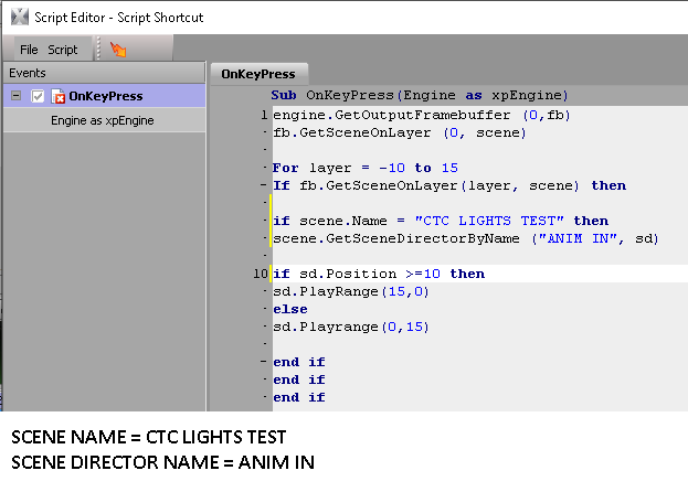

    OK, I put the script in the keyboard mapping.  I changed the name of the scene to "CTC LIGHTS TEST" and the scene director name to "ANIM IN" reflecting what they are named in my project.
    Here is what my script looks like:

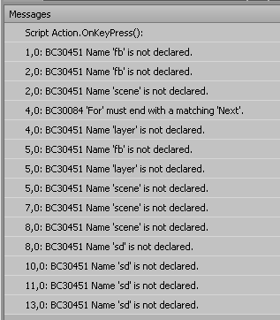

    After compiling (F7), these are the error messages I got:
    I'm sure it's probably due to the fact that I am not well versed on scripting, but can you tell me what to change to fix these?  Thank you

    right off the bat I noticed you didn't include the "next" at the very bottom. This makes the script loop back to the FOR so that it will run on different layers. I need to clear that out for next time. Try that first. Also the top lines where it starts with "dim" needs to be there too. This is where you tell the script the names of the variables you want to work with.
