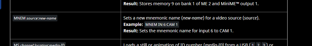

It is possible to send Mnemonic name changes to Ultra via RossTalk - Note unlike TSL UMD protocol this will update the source Label in the Input Table as well as the panel mnemonics.
https://help.rossvideo.com/carbonite-device-db/Topics/Protocol/External/CNT/RT-CNT-Comm.html
lists the commands with the MNEM command being the one you would send from DashBoard. You would need to build a DashBoard Custom panel of some kind that is going to be tied into your Labels and I speculate some kind of Router I/O Panel that would need to be running that will you will add code to send updates to the switcher based on changes to specific outputs.
