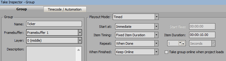

    Sounds like maybe you want "Timed" Playout Mode for your group.
