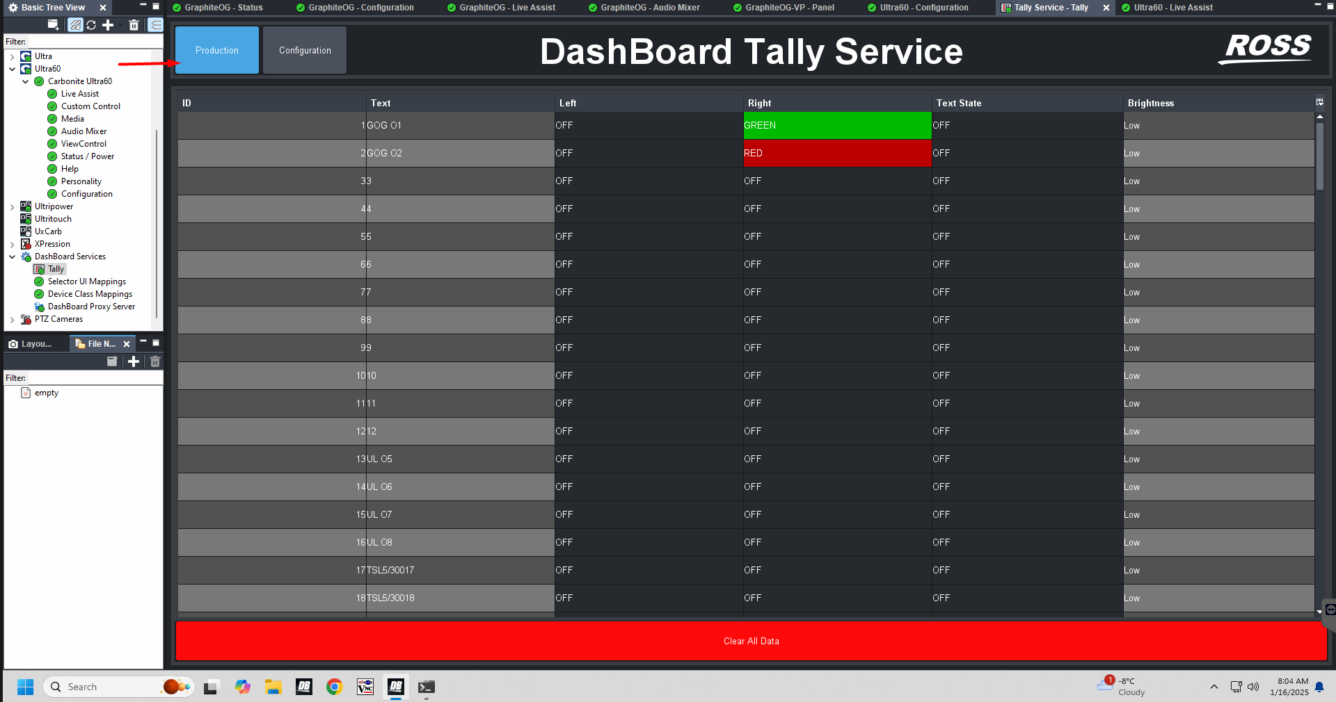

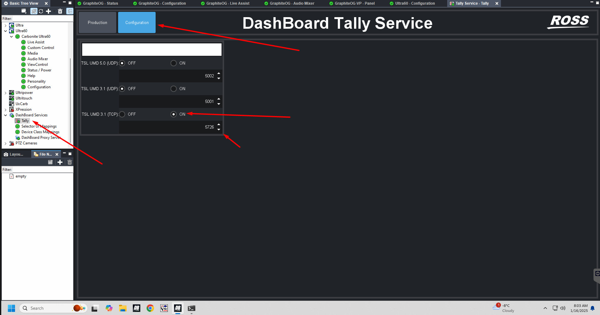

I just tried this on v9.1.3 of Ultra 60 and it works.
3.1 is limited but it is sending out data.
I used the DashBoard Tally service to test it.

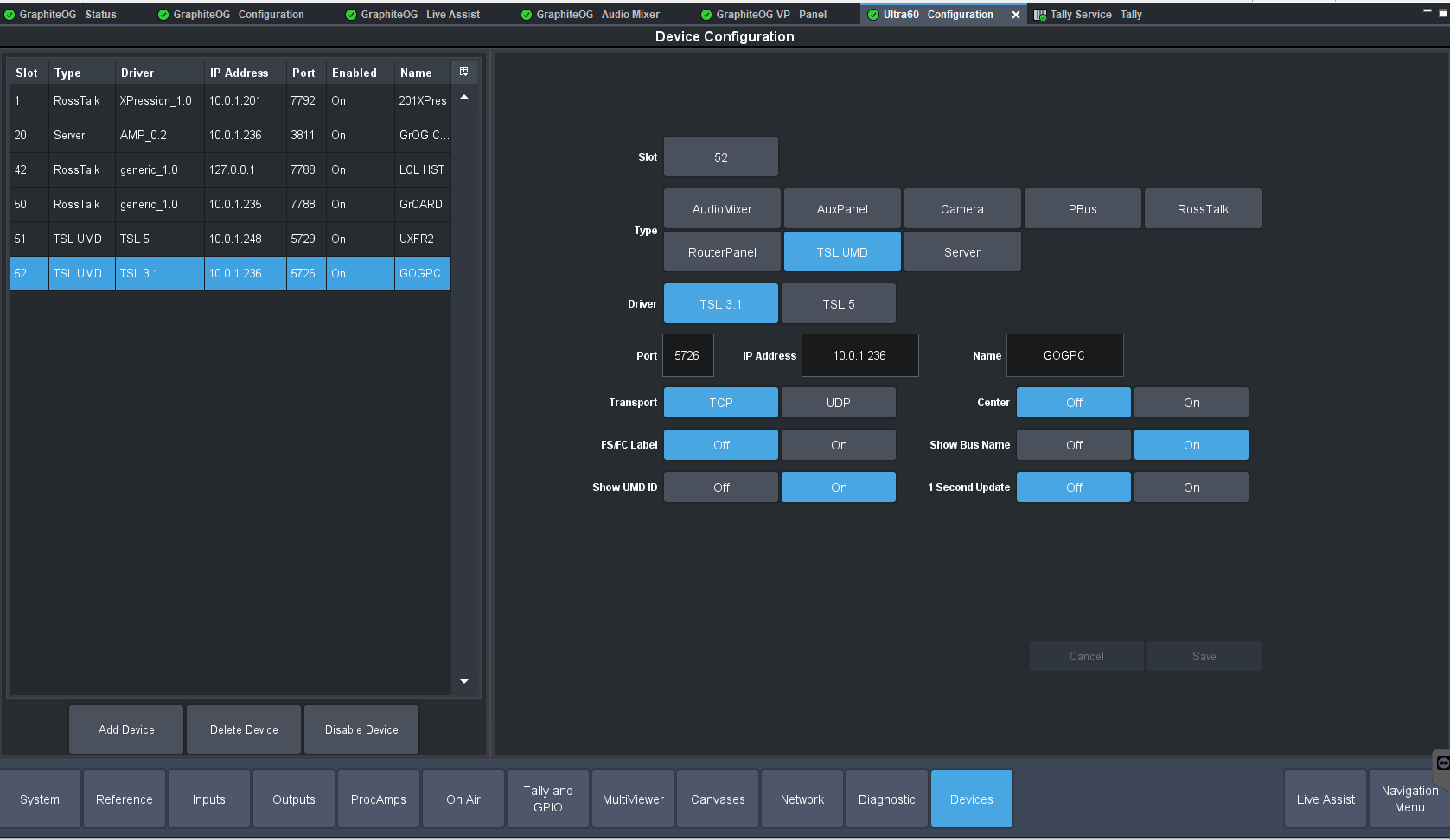

Setup to send to the PC that DashBoard is running on ..
Setup the Tally Service to enable 3.1 and chose a port to match what I setup in the Carbonite.
Went back to production:
That shows me as I change sources that it is working.
