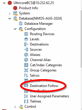

    Hi Shane,
    Are you assigning Desitnation Follows through the Ultriscape head selection or the Destination Follow database menu?
    The Desitnation Follow function in Ultriscape is being deprecated, and will be removed as of version 6.5. I'd recommend migrating your destination follows to the Database Destination Follow menu, and setting all Pips to Normal in the Ultriscape Head Selection menu.
    Here, you can generically assign any destination as a Follow, in addition to Pip destinations.
