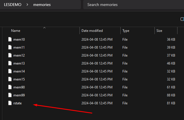

    Jeremy -- Les, specifically what is the Rstate file? It seems quite important to a sucessful show load?
    Rstate is the Reset State it is effectively a Memory that the user can setup per show file to have the State that the Switcher "Reset" / ME "Reset" or a Reboot will come up with and "recall".  Think of it like Memory00000 that you setup the switcher and have everything the way you want for your Show Default.  normally we would do that by storing Memory0 or Memory99 etc.  But then a reset/reboot or an "ALL-ALL" in Ross terminology to clear out an ME or the whole switcher had no way for the operator to define that default.  Thus in Carbonite (so like 2011) we introduced RState. But Like any other memory, setting, configuration, personality.  The user/operator needs to "create/store/set" that and save it with the show.  Otherwise it will have the Default RState which is what this user is experiencing.  They have moved from an Older Series. Rebuilt their production but missed configuring this step.
    Jeremy -- Why is it separate from the 'saved set' file?
    It is Not separate -- it just was not setup/stored by this user.  It is located in the same folder of the show file as all the other memories:
    Jeremy -- Its seems odd that the switcher would save data in various locations and not all in one file no?
    It does not save it in a different location.  It is part of the same location inside of the Show file structure.
