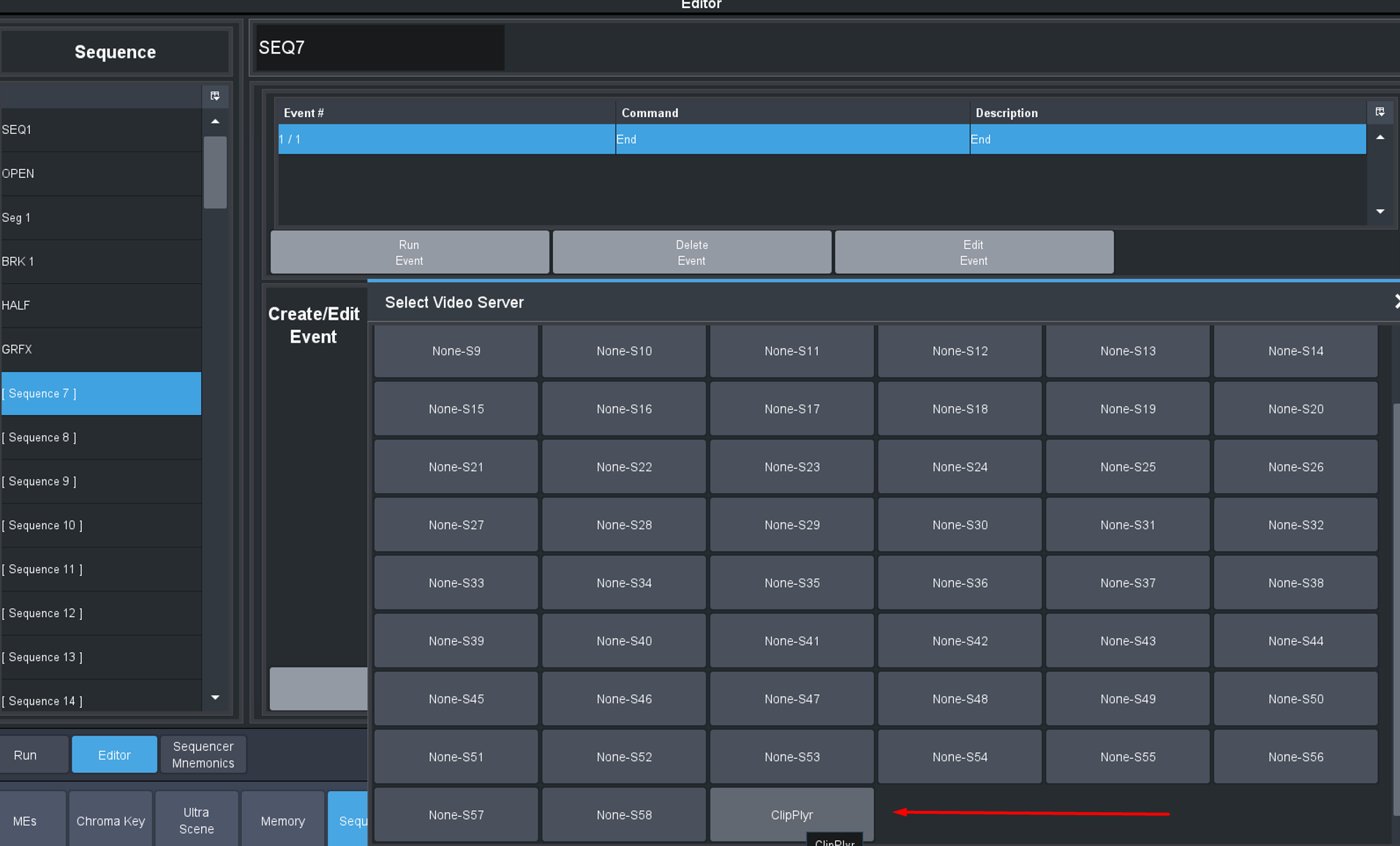

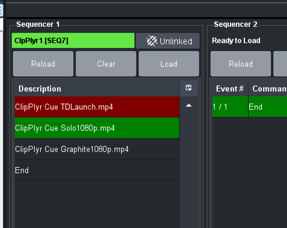

Yes you can Cue and control the Clip Player via the Sequencer.
You use the Device Control - Video Server Events.
Make sure for the "device" you scroll down to the bottom of the list for the ClpPlyr

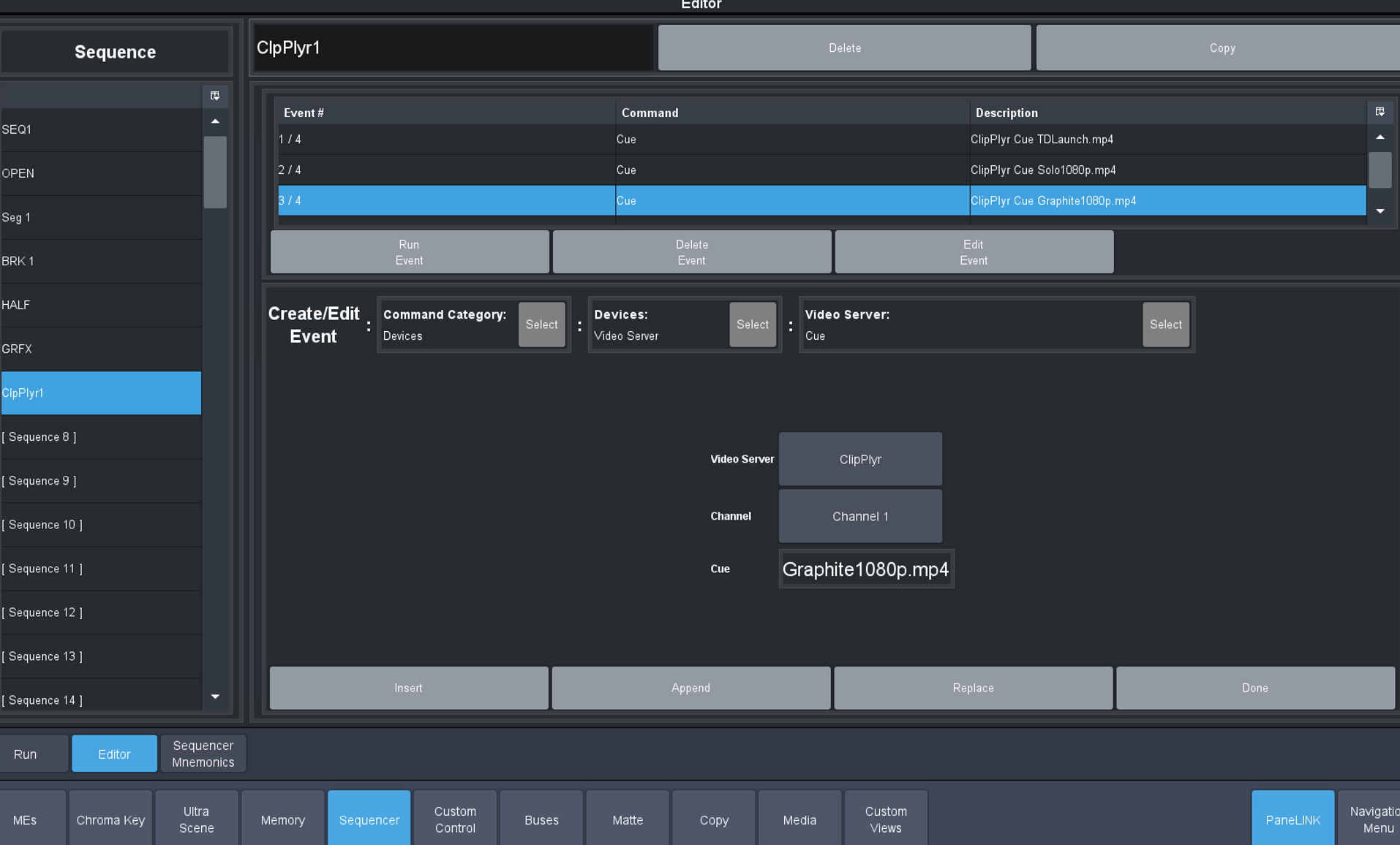

Then Type in the Name as you see it in the clip menu
Make sure to keep those .mp4 or .mov extensions are there.
