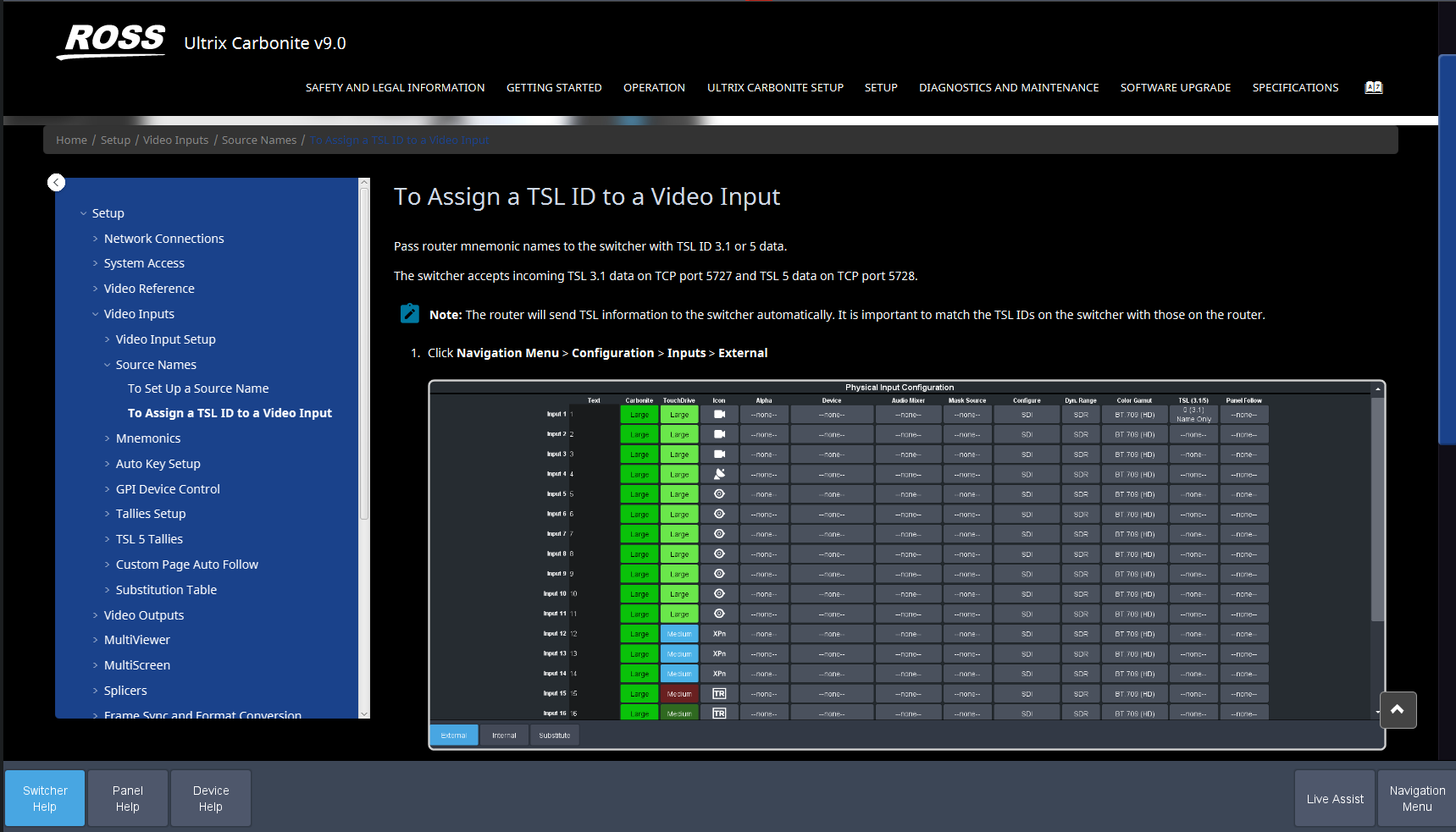

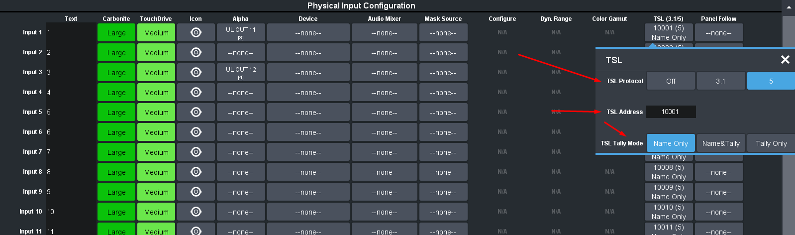

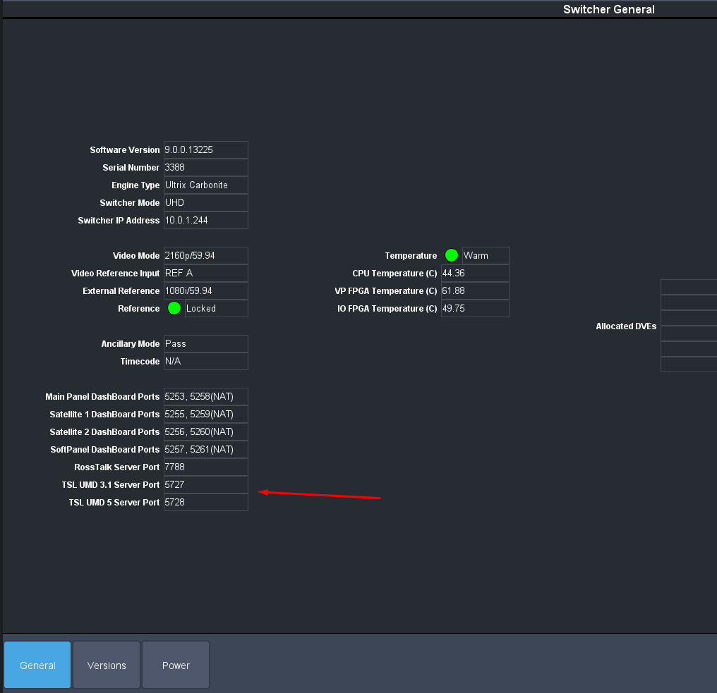

Tallyman will send the TSL Tally protocol to the Carbonite switcher using TSL UMD v3.1 over TCP with those profiles I believe (you will need to confirm that with TSL)
When setting up the Carbonite to receive the Tally Data you can configure it per input to receive the Just the Name, Just the Tally or Both. You also have to set which UMD ID that input is tracking.
This should control the information.
