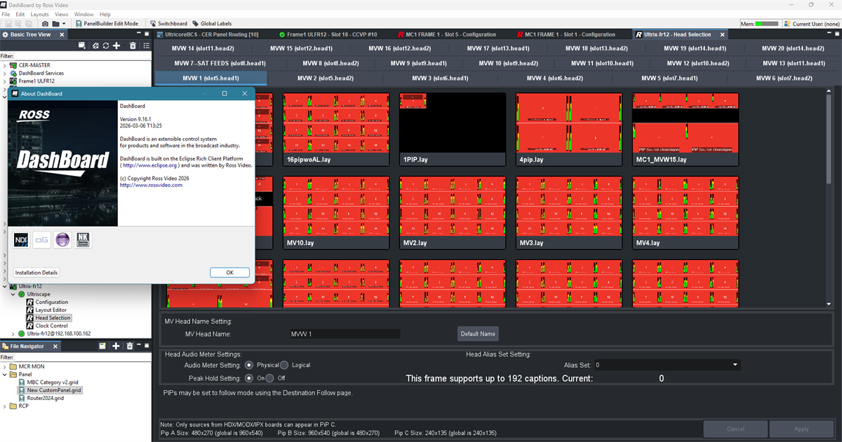

  • 3.  RE: Ultrix FR12
    Posted 04-22-2026 01:40
    Hi Aury,
    I have checked and I think the version on the ULTRIX  Ver6.7.4 does not have the the dropdown list on the ULTRISCAPE HEAD SELECTION Menu as below:
    Please advise.
    This is actually causing much impact on our daily operations as these dropdown menu was active for quality control and monitoring. Easily accessible.

  • 5.  RE: Ultrix FR12
    Posted 04-24-2026 11:51
    I believe the destination follow feature has been changed.  It is no longer a part of the UltriScape layout and is only available in the Destination Follows assignment page in Ultrix Dashboard.
