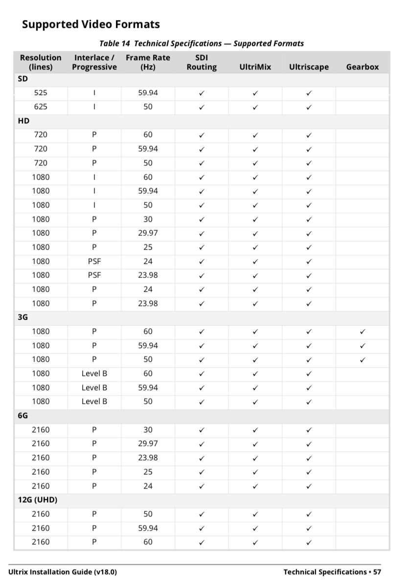

    Is anyone aware if the Ultrix can convert 4 Cable 2SI UHD at 23.976 or 29.97Hz to 6G in the gearbox?
    59.97 works fine but we'd like to be able to route at sub 30 frame rates.

    We don't officially support 6g gearboxing but it does work At 1080p 50 hz and up...not below.
