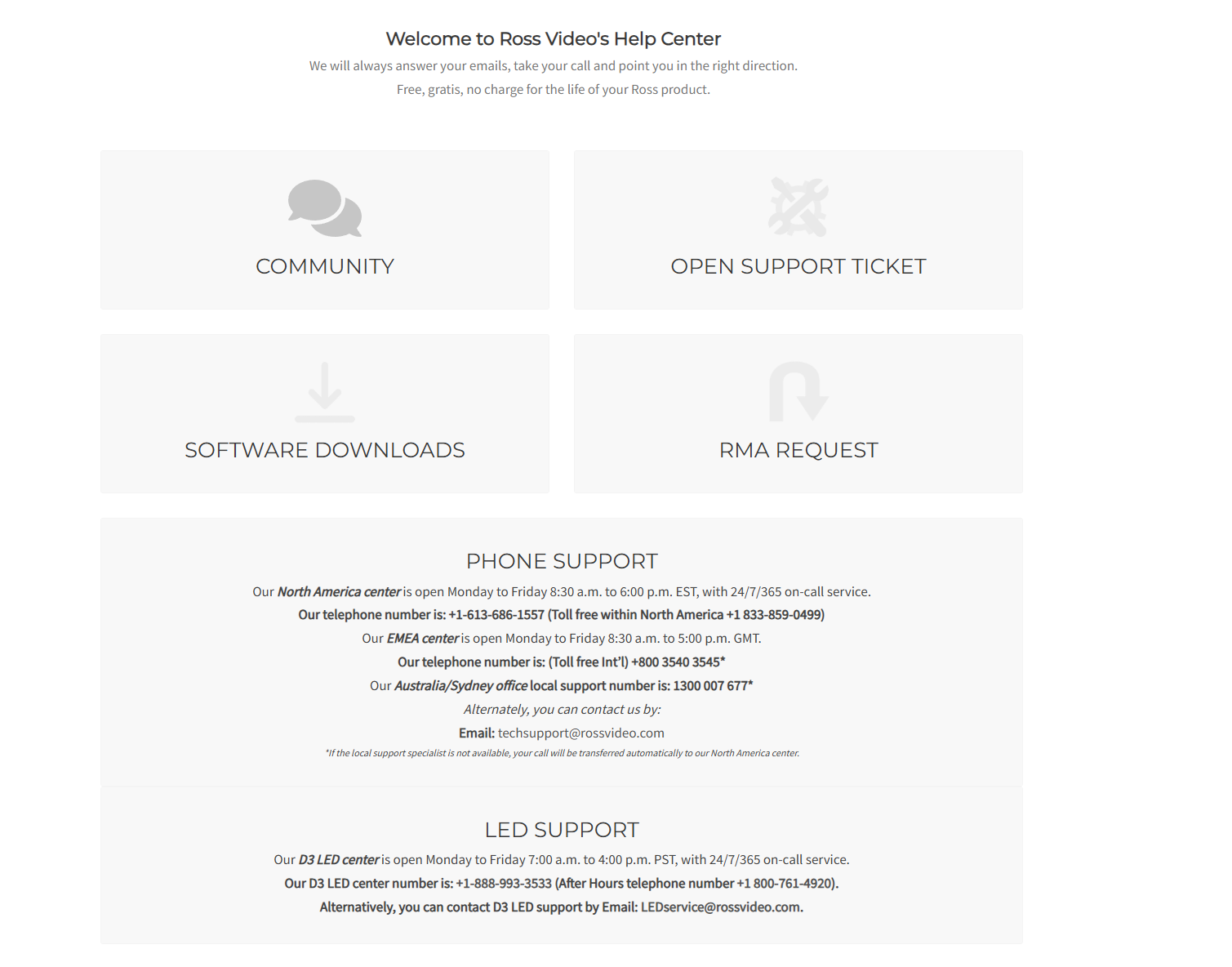

    Please Call Technical Support with Critical Issues.
    The Community is not monitored by Technical Support and does not provide the creation of a Ticket and processing in the system.
    That has links to open a ticket - Toll Free phone numbers to call.
    The quickest way to get support is to call.
