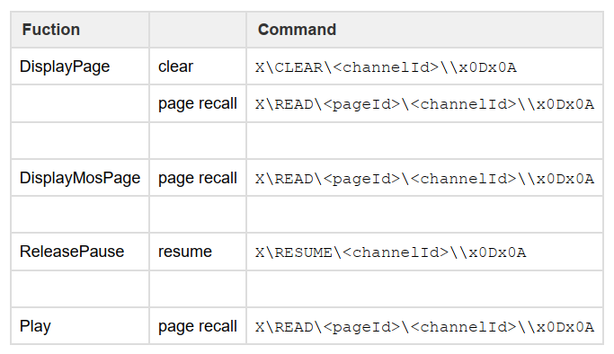

In Ignite version 7.1+ you should have the Display Page clear command that can select channel ID to clear.
This will send either the Y\xCA\\ command or the X\clear\channelID\\ commands depending on your Ignite version.
The clear command will take the XPression graphic offline with NO animation. If you want to trigger XPression graphics offline with an animation you need to build your XPression graphics with pauses that you resume, and the XPression graphic timeline will have a offline command built into it. So Ignite will trigger the graphic, and then resume it to take it offline.
I don't recall how the Nexstar gfx package is built.
In Ignite version 11.1.3+ (which I strongly recommend you have for XPression control) - you should have the DisplayPage clear comamnd, AND (I think) another command I don't know the name of that sends X\TAKEOFFLINE\takeID\. The TAKEOFFLINE command will trigger the OUT animation of the graphic, triggering the transition logic out animations built into the graphic template.
Ignite v11.1.3+ is also required for triggering the preview channel of XPression from Ignite - using the X\UPNEXT command.
