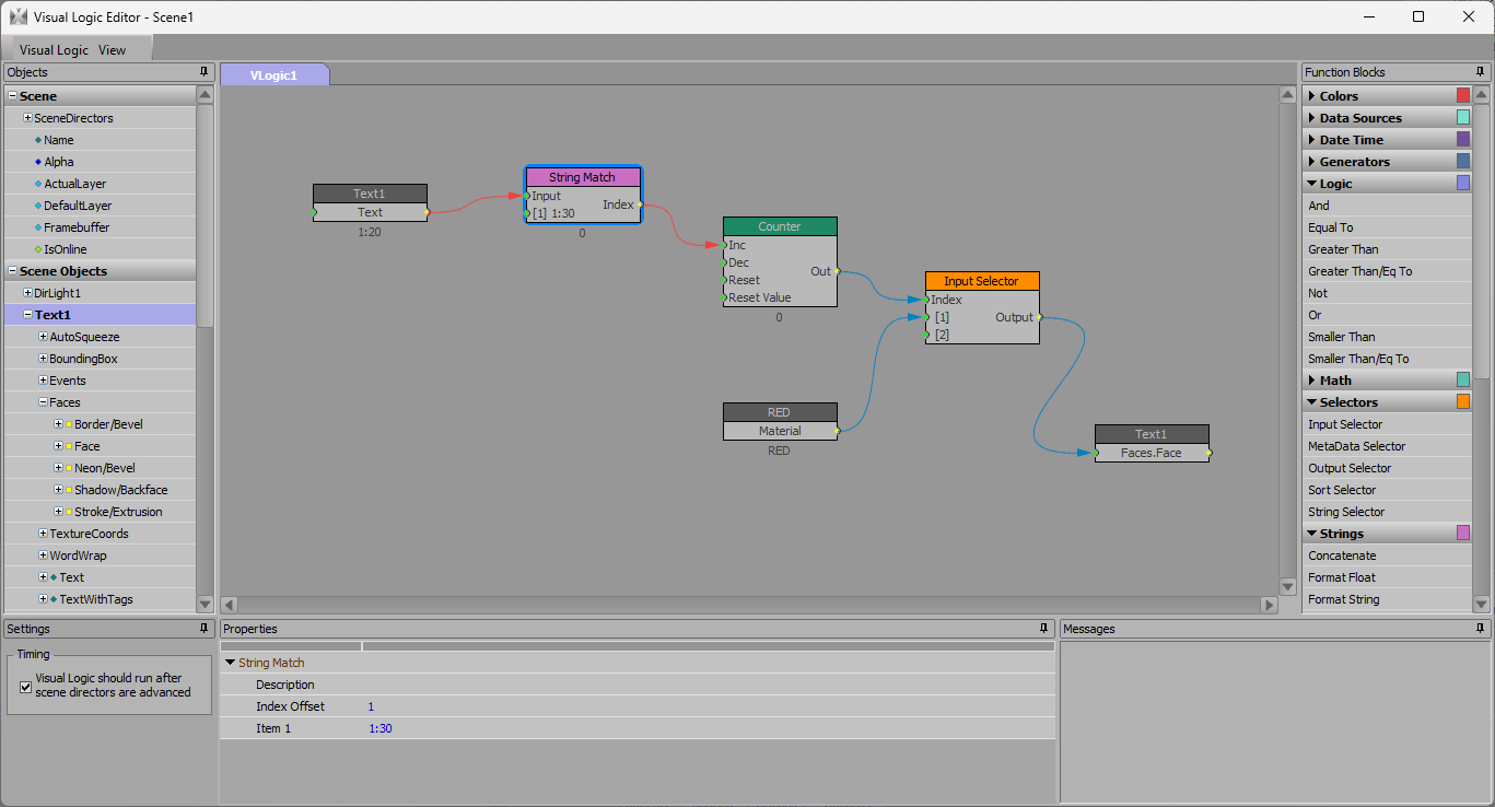

    You should be able to do something like this with Visual Logic. Here's a quick example:
