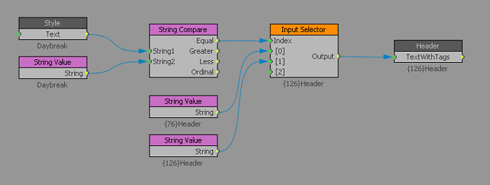

That's because you have fixed strings.
What you want to do is something more like this;

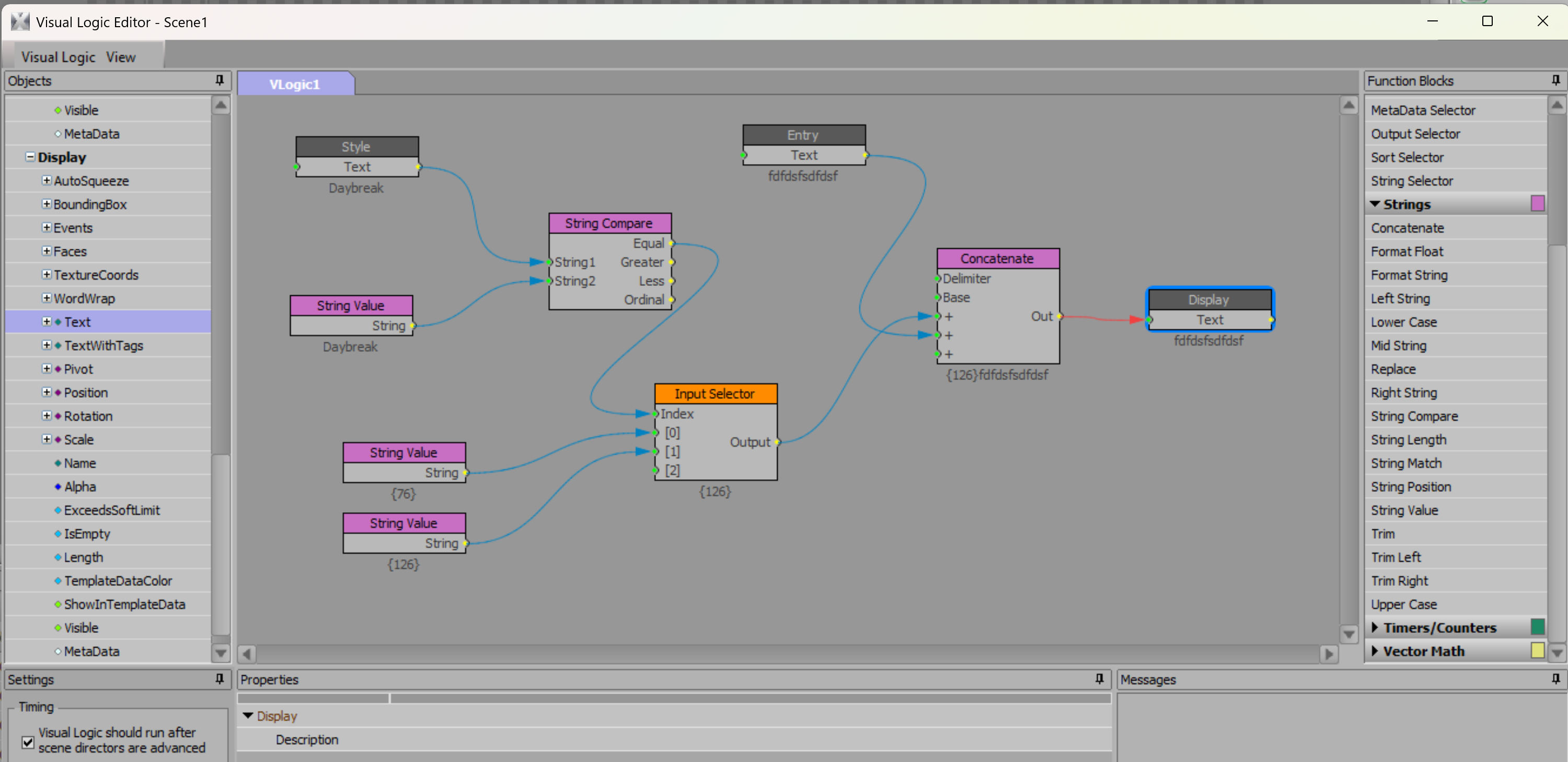

Subject: Using visual logic to hide text shadow according to 'style' widget
Thought I had it....ended up using the tags. Font is changing but the text is not updating from the moss...just keeps saying 'Header'

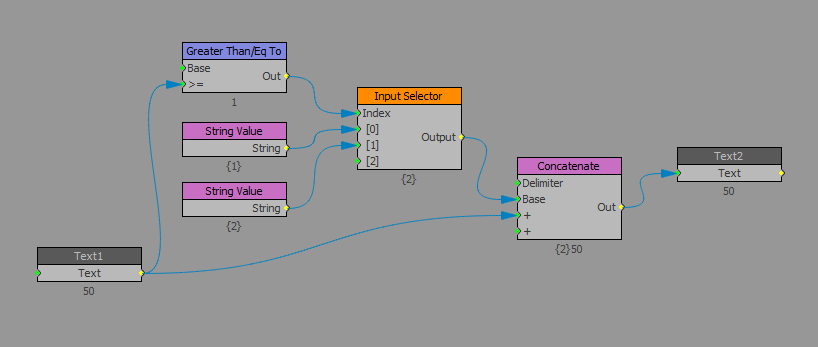

Every Font used in Xpression has an ID (written in Buttom-Left for every font when you are Scene Font).
Create 2 fonts as you want - one with Shadow (let's suppose it has ID 1) and the other one without Shadow (let's suppose it has ID 2).
Create a Text 1 object and write 50.
Create a Text 2 object and leave it empty.
Create a Visual Logic with:
- one String Value and write down at Value: {1}
- other String Value and write down at Value: {2}
- grab the Text from Text 1 - Scene Object
- grab the Text from Text 2 - Scene Object
- Grab "Greater Than/Eq To" from Function Blocks - Logic and write down in Base 50, and put the Text 1 output into >= sign (to compare it with value 50)
- Grab an Input Selector from Selectors and put the Out of "Greater Than/Eq To" into Index, link the first String Value to [0] and the second String Value to [1]
- Grab a Concatenate function from Strings; link the Output of Input Selector in Bse of Concatenate and Text 1 intro +; Link the output to Text 2 input.
Now the Text 2 object should have the same value as Text 1 but with Font 2
When you are changing the text of Text 1 with a lower value like 40, the Text 2 will get same value - 40 using the Font with ID 1.

You can use font tags such as {43} or the font name {myFontName} or you can just change a material {M:RED}.
