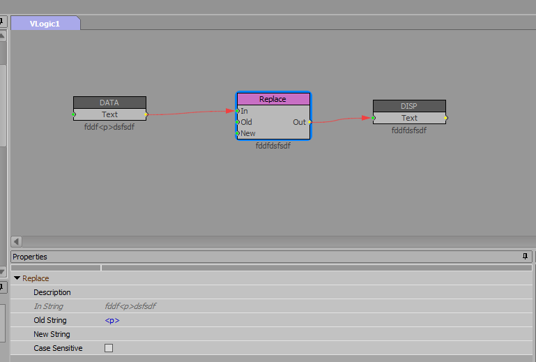

Thanks Simon,
I was looking at that but got a bit lost with how exactly to set it up

Sent: 10-06-2025 09:47
From: Simon Redmile
Subject: Using Visual Logic to remove text from data
You can use the replace string block
Sent: 10-06-2025 09:21
From: Daniel Briney
Hi All,
I have some data coming in that looks like this:
<p>This is the information I would like to keep</p>
I am trying to figure out how to remove the <p> and the </p>
Does someone know the correct visual logic to help me?
