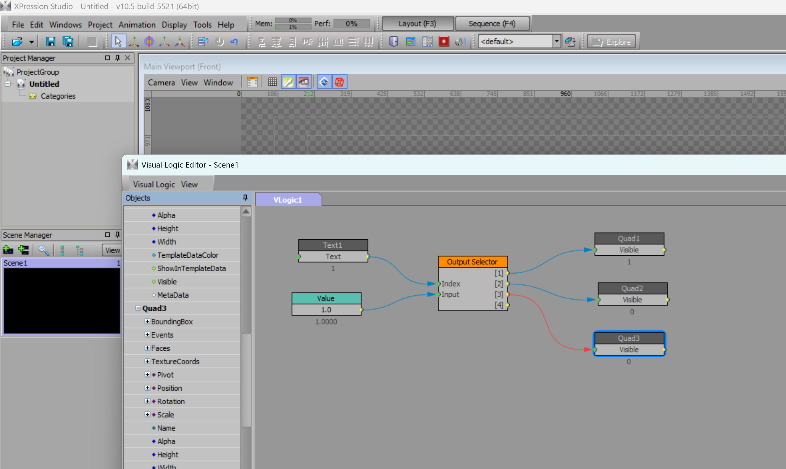

    Hello, I am new to the visual logic world so I apologize if this is super basic. I have a lower third built and it has three variations: single line of text, two lines of text and a single line of text with a widget. Is there a way to make it so when one is visible the other two are not? Thanks in advance!

    You can use the output selector in visual logic.

    Awesome thanks! Can you explain what is going on the left side? If text1 has a value of 1 it makes quad 1 visible and the other two invisible correct? What is the value from? Is it just if the text 1 is visible? Is there a way to make it if Quad1 is visible the other two are just invisible? Would I have to set it up three times?

    A value of 1 2 or 3 will decide which is visible.
    Value comes from the a widget connected to the text object.
