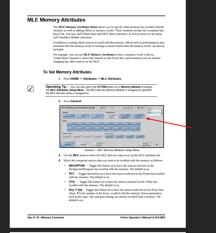

You will need to use the attributes menu to disable all of the elements including Buses that you do not want to change.
But yes you can do this in a memory.
Before you store the ME 4 Memory press the Attributes button and toggle the items you don't want to change.
basically turn everything off but the Transition Area Button then Save the memory.

I don't think there's a way to do this, but I have to ask.
On a Vision switcher, is there a way to create a custom control that modifies wipe parameters?
We have a board wipe that is a specific pattern, and I have it set up with a Custom Control on ME4 so I don't have to use an MLE. I also want to create a white flash board wipe on ME4, so when I create the Custom Control for that and I manually change the wipe parameters, then try the first wipe again, it will change the pattern but nothing else.
I know that wipes need to be saved with memories, so my next question would be, can I save a memory on ME4 that doesn't affect PGM/PST and keyers, and only changes the wipe pattern, that I can call up as part of my custom control?
