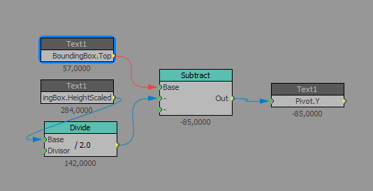

    Hi.
    Try like this
    Roman Yaroshenko
    chief specialist
    RBC-TV
    Moscow Russian Federation
  • 9.  RE: Visual logic
    Posted 07-01-2025 08:46
    This is it. Thank you for sharing.

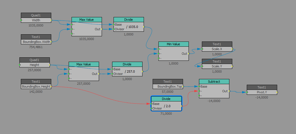

    On another note just because I tried this out now. Do you know of any way to keep it centered vertically even while using autosqueeze height&width? Since when using that it will still be off center once the text starts to squeeze.
    Best wishes,
    Johannes
  • 11.  RE: Visual logic
    Posted 07-03-2025 04:42
    Hi.
    In this case I would not recommend using the autosqueeze function. In the picture below VL, where Quad 1 is the width and height limiter for the text.
