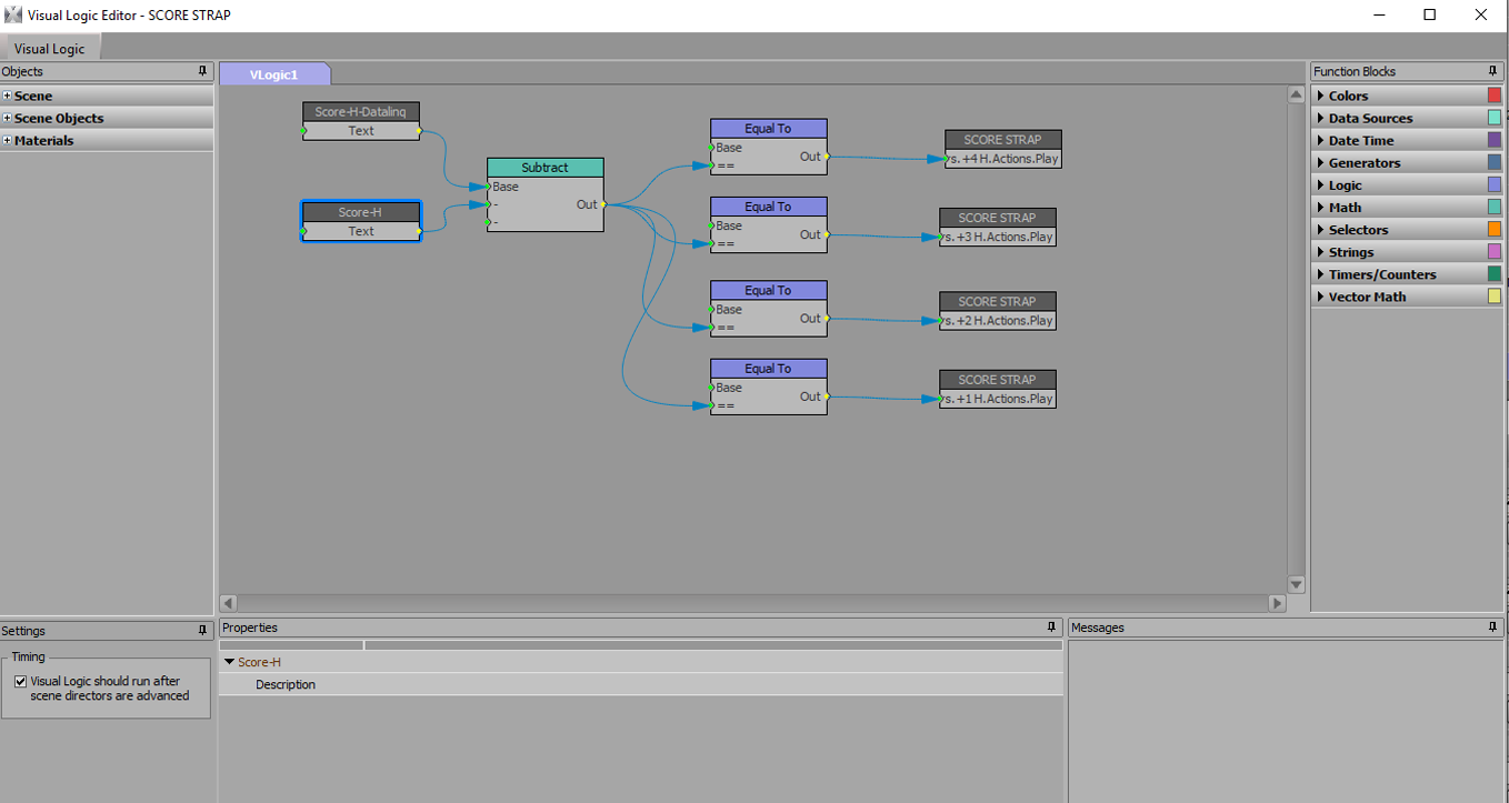

It's because once you play the scene directors they are technically playing so they won't play again.
You need a way to pause or stop then and put the position back to 0.
In scripting we use a feature called autostop but I don't think that exists in visual logic.
You could try putting an event at the end of the scene director that stops playback and puts the position to 0, that might do it.
Sent: 10-07-2025 09:29
From: Donald Blair
Subject: VISUAL LOGIC
i'm trying to trigger an animation with a score increment of +4, +3, +2, and +1 using visual logic. i'm able to trigger the animation once unless i go offline and online again.. it seems like the animation doesn't reset..
Donald Blair
TV5
