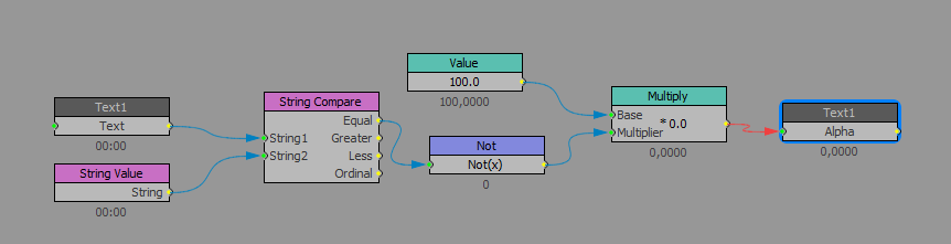

Thank you so much Roman, that worked a treat. Really appreciate the help.

Hi Simon
Try something like this

From: Simon Hynes
Subject: Visual logic for timer off lining when hitting 00:00
Hi sorry, I'm new to visual logic and this probably the simplest thing to do, but I'm having trouble figuring out how to get a timer to either automatically offline itself when the timer hits zero or reduce the alpha from 100% to 0% when the timer hits zero. Any help would be much appreciated.
