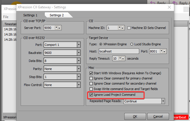

Unlike Chyron and VizRT, XPression is a project based CG, not a file template based CG. An M\ command is NOT used to load the template before triggering it. A single XPression project can contain a (nearly) unlimited number of templates. The M command in XPression is really only used to load the project ONCE - it shouldn't be sent repeatedly. The M/ command in XPression requires a full valid path on disk to load the project - Ex. D:\Projects\News\Evening.xpf
The XPression CII Gateway application actually includes a setting to "Ignore M commands" to stop systems from constantly trying to load projects (because those systems are treating XPression like a file template based CG).
