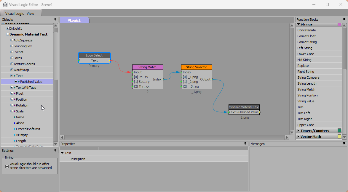

    Hi everyone,
    I have created a dynamic string in VL and connected that to a text object and when i am using the same text object as macro @@ into a Dynamic Material path of a quad, the image doesnot go onair until i press the TAKE button twice. Anything that i am doing wrong OR a work around would be appreciated.
    Thank you
    Gaurav

  • 5.  RE: VL + Dynamic Material
    Posted 19 days ago
    Gaurav,
    Two things you can try.

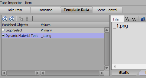

    1. If you're running XPression 11.0 or higher, instead of using VL to feed into the Text property of your TEST text object, send the result of the VL into the Text.Published Value property. This will put the result of your visual logic into template data earlier than it would the text of the object, allowing that text to be used in other functions of the scene like Dynamic Material paths.
    This will also make the resulting text from your visual logic available in the Take Inspector in Sequencer, which may or may not be preferable in different circusmstances.
    2. Alternatively, you can add a simple script to the onOnline and onPreviewRender events of your scene to rerun the Dynamic Materials after the visual logic runs
    self.RefreshDynamicMaterials
    Depending on what type of manipulation you're doing to your text, there may be ways to use a combination of User Input Controls and Assign Columns to get this done outside of VL as well, which would take care of the order-of-operation issues itself.

  • 6.  RE: VL + Dynamic Material
    Posted 15 days ago
    Hey Jeff, thank you for your response. The script did the trick and the scene is working flawlessly.
    I tried the 1st option but that yeilded no result i.e the dynamic material didnot set when the graphic was taken online on sequencer. Then i added the single line script and it worked.
    'Published Value' of text object in VL is something new that i have become aware of now. What is the use case scenario for this? I read that u wrote '...send the result of the VL into the Text.Published Value property. This will put the result of your visual logic into template data earlier than it would the text of the object...' so why not have one property of the text object rather then 2? This is just for my knowledge so as to understand the basic principal behind having 2 properties of the same object in VL.
    Thanks once again for your help and recco.
    Gaurav

  • 7.  RE: VL + Dynamic Material
    Posted 12 days ago
    The Published Value was added to makes data from Visual Logic available earlier in the template workflow for dynamic material paths other features like @Text Object@ macros.
