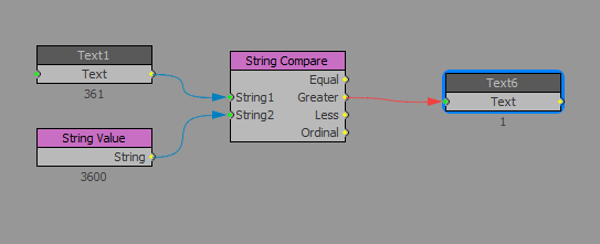

    Guyz, any particular reason why this is happening? Any number between 361 to 999 on Text1 will return a value of 1 i.e String1 is greater then String2.

    For comparing numerical values you should be using logic blocks.

    Thanks Red. Also, when i want to use LEFT/MIDDLE/RIGHT String, the string output rounds off to the nearest value. How to avoid this?

    Its probably because you are changing between numbers and strings. What are you trying to do?
