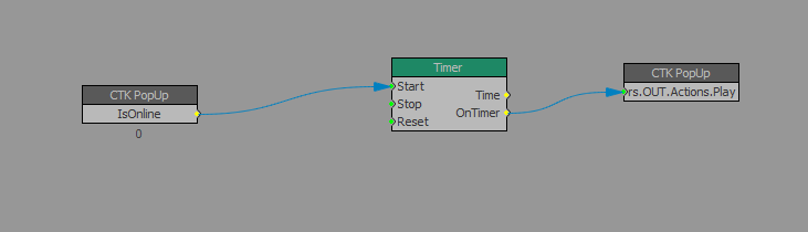

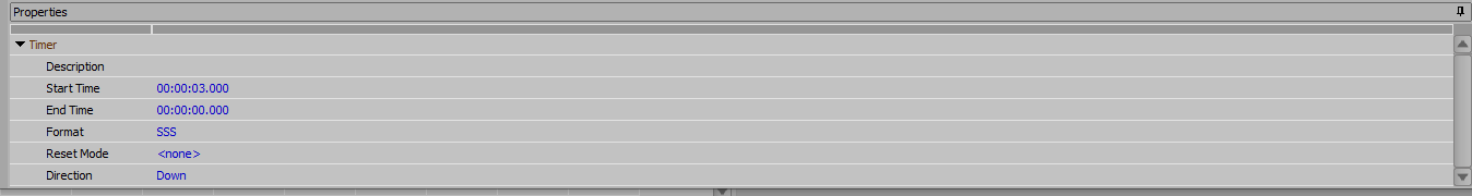

I also tried just running a static timer between the isOnline event and the play action for my OUT Scene Director and the scene director never plays!
