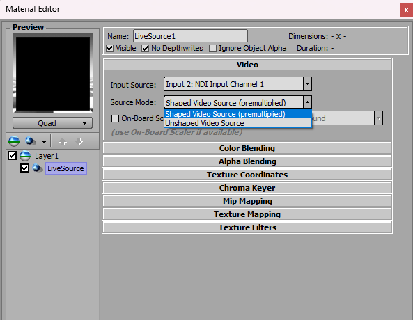

    However, we are having some issues with the Alpha channel. It appears choppy and "wrong" around the edges of the graphics.
    Is this a known problem? Anyone know what I might be doing wrong? We are running Xpression version 11.5 at the moment.

    I don't have an NDI source with Alpha to test with, but have you tried changing the source mode on the Live Input material?

    Support for NDI inputs with alpha was added in XPression v10.5, so any version 10.5 and above will have it.
