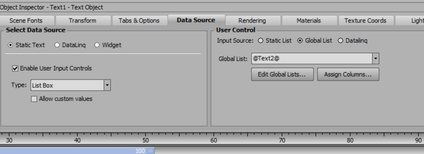

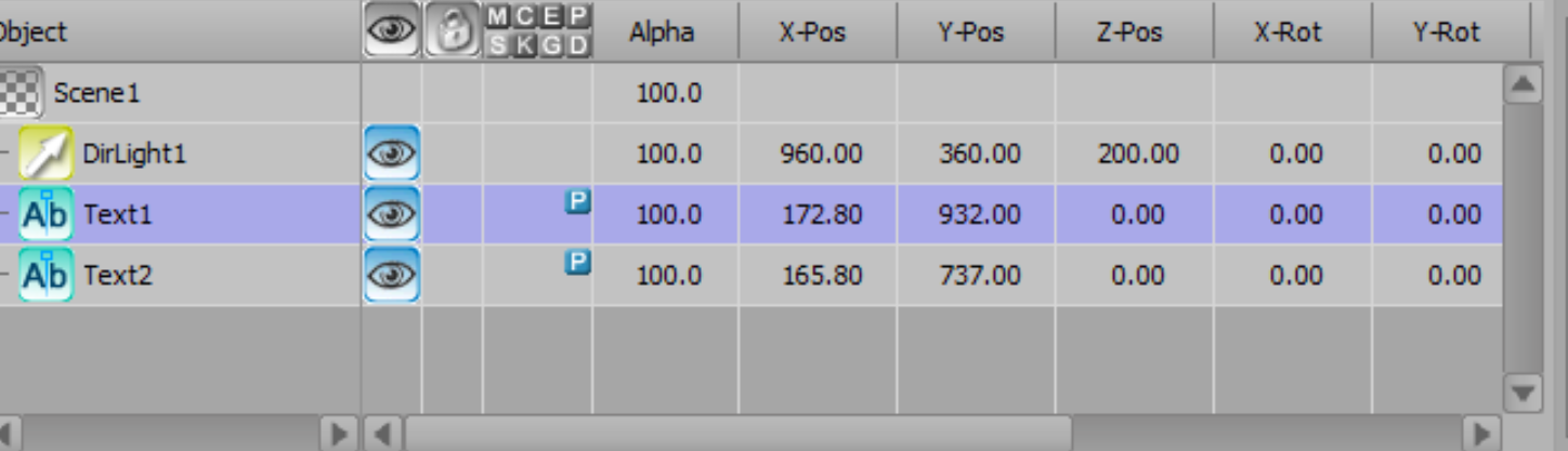

    So you could make a dropdown list of global lists names in dasboard and link that to a text object in XPression and then use that text object as the global list name.
    A lot of people don't realise that macros are allow as global list names eg @globallistname@ so you can have a varible global list.
