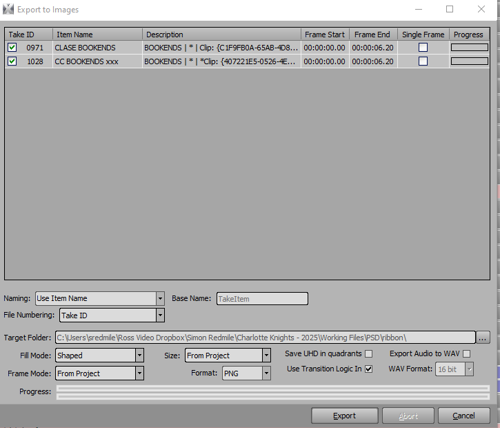

    We generate lower 3rds on Xpression then export them out as .png where they are loaded into Carbonite. This makes the recall faster then using Rosstalk (which is our backup for last minute items).
    When I export, all the .png file names are the same, the item name. This is less than ideal as I need to retype all that information. I'd like each .png file to be taken from the description field. (image attached)
    Is this possible?

    What version are you on?
    I am on version 12 and you can select to use Item Name instead of base name.

    Posted 05-12-2025 17:41
    I'm on version 10 and I don't have that function. We are using Xpression that came free with the Carbonite (Xpression Designer 1.0 is the license). Am I eligable for that version?

    Posted 05-13-2025 14:34
    The improved Export to VIdeo/Images menu was added in XPression version 10.5. So if you are on version 10.0, you can upgrade to version 10.5 even if you do not have an active software maintenance contract. Tech Support can provide you with download links to v10.5.
