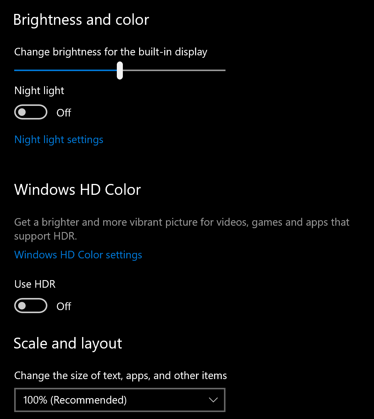

    I am trying to figure out what you changed to make this work for you know Donny. I am looking at Simon's screen shot but for some reason I don't see what made the eye dropper work for you know with what Simon suggested. Can you share please what you did?

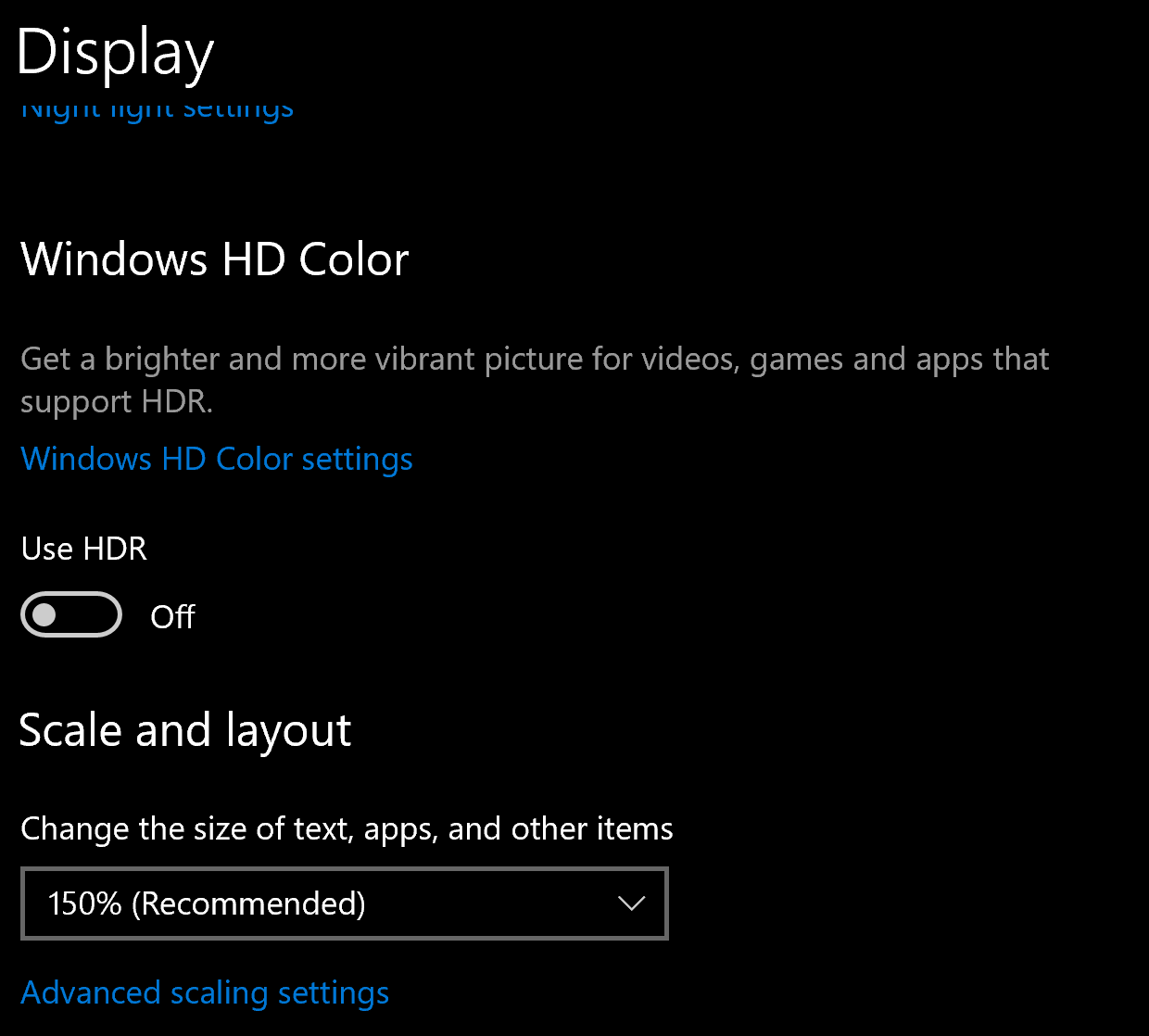

    Those settings are in your Windows settings. So open "Settings" from the start menu, select "System" and then "Display". From there you have to set the screen scale to 100%. I had mine set to 150% so it was easier on the eyes. I guess when you do that the eye dropper is working as though the screen is set at 100%? ... which is a bit annoying!
    I'm not sure if you have to have your monitor(s) resolution set to their native size or not though. Mine is though and the dropper is working as it should.
    Let me know how it goes.

    Nope, didn't have to restart. Yeah, I keep my monitors (extended as well) at 150% normally. If I (or we) need the eye dropper tool I guess we'll have to zoom the monitors out to 100%. Kind of a pain!
