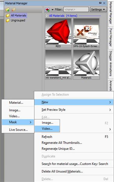

    Posted 04-07-2023 10:42
      |   view attached
    Hi DK-Han,
    incase you just want to use your black and white video as a reveal or transition you need:
    1. have the black and white information in the alpha channel of your video - video tutorial B124
    Merging two Videos to Create an XPression Video with an Alpha Channel - Ross Video
    or possible in After Effects with having the material as a luminanz alpha
    2. just ad material -> then mask -> then video
    It actually does nothing else then setting all the blending modes automaticly like in the pic. above.
    3. Create a layer in the scene and put your video mask and the material etc. you want to reveal in the layer  - be aware of Z-achsis or position above or under with the mask to work.
    The mask video can be draged in the scene director or have a start automaticly - all works.
    From what I got above I think you had the black and white informatin only in the fill and not in the key (alpha) of the video.
    Attached a example - incase I understood what you want to do wrong just mail me directly what you mean.
