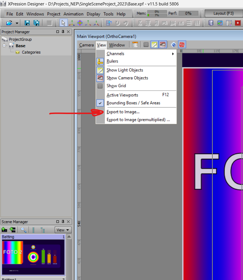

    Garret,
    Only in layout mode you can save a snapshot. So drag you scene from layoutmode to your virtual output bufer, move animation to the frame you need, and safe it.
    Robert Simons
    XPression Artist
    NEP GFX
    Hilversum Netherlands
