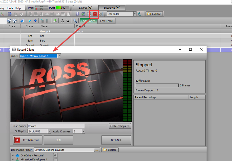

    Do you see the live input video inside the XPression Record client?

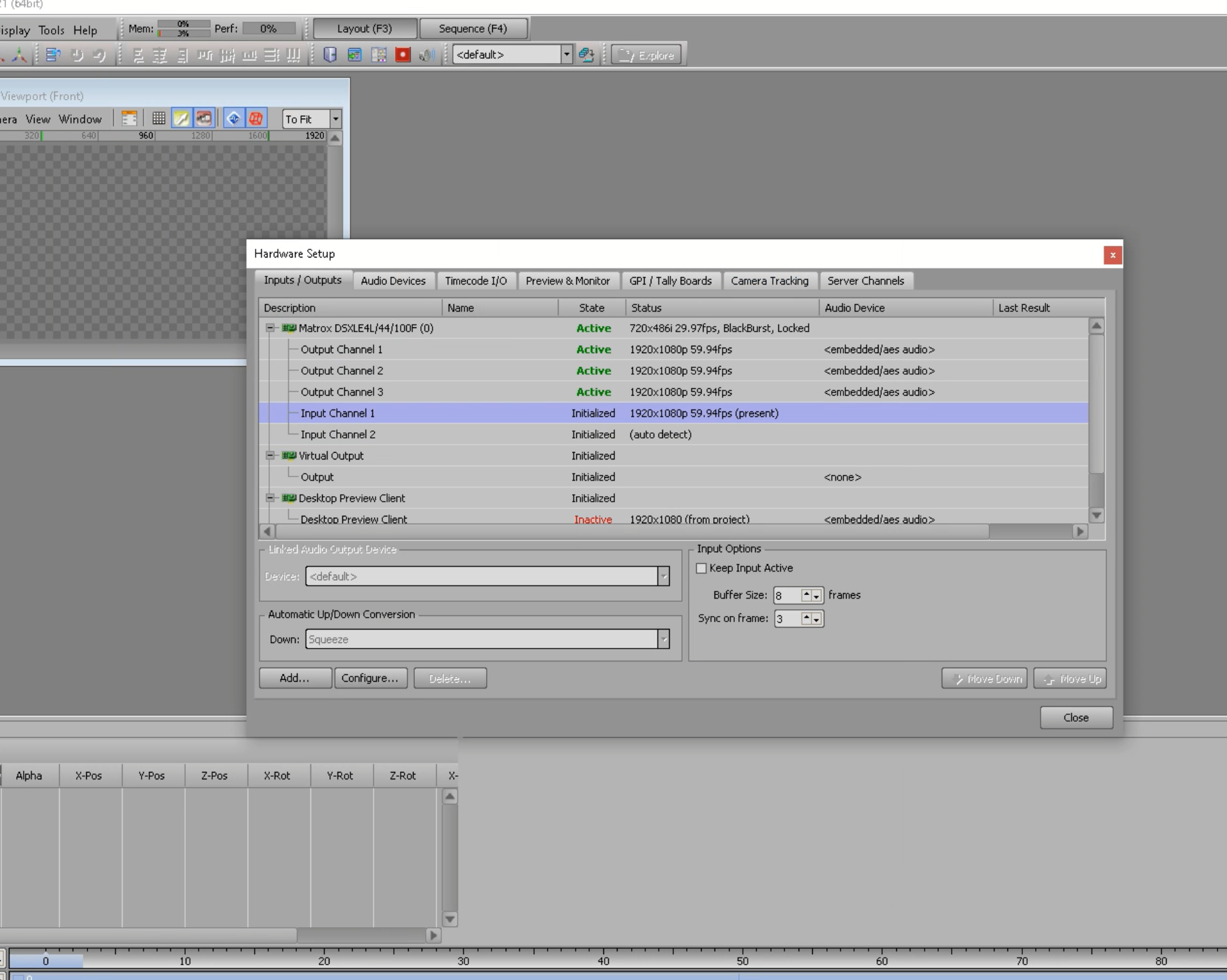

    The record client does see the video and the input say "initializing", yesterday I swear it said active, I don't know the difference there or how to make it active.

    Hardware setup will show the input as "Active" when:
    - the input is active in the record client
    - the input is active in the viewport
    - the input is active on a rendered output
    - the "keep input active" setting is enabled
    So you see the video input in the record client but not in your material/viewport?
