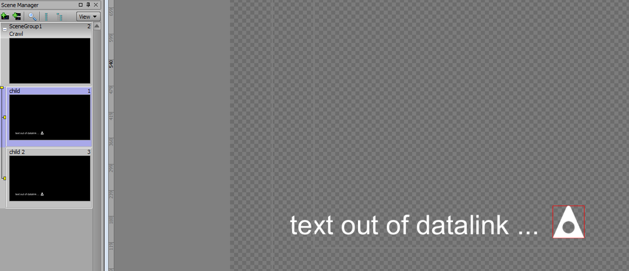

Do not know exactly how you build it but I asume the calssic way.
One way is in the childscene of the crawl build in with Visule logic when Text line is empty = visibilty of quad with logo = 0.
Cheers Nicole

HI,
I've been working with xpression in creating a crawl and adding a logo in between each crawl. I'm using datalink for the text and the logo. It's all reading to a excel worksheet. It's working like I want but when I clear 1 line of information, the logo still stays on. I tried data linking the entire row, but that didn't work. Anybody have any suggestions? I hope I explained it correctly. I attacked the excel worksheet.
Thank you.
