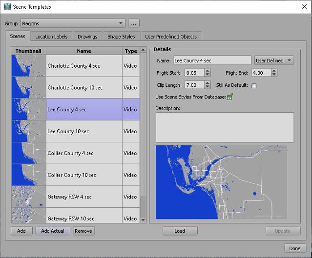

Hi Andrew,
Here is an explanation of the options you have available to you.
Flight Start determines when the map flight begins. This allows for a pause before the Map starts flying.
Flight End determines when the map flight will reach its destination.
Clip Length determines the overall duration of the clip. This allows for padding after the map flight ends.
With your current configuration, the Map will start flying at 0.05 frames after the start of the clip, reach its destination at the 4 second mark, then there will be 3 seconds of pad at the end of the clip where the map sits at its destination.

Sent: 07-23-2025 12:19
From: Andrew CLOAD
Subject: XPression Maps Flight Length Issue In MOS
Hi, new to XPression here. I can't figure out why map clips are longer in ENPS/MOS than what I have the scene template set to on the designer side. I want a 4 second flight, but as soon as we bring it in to MOS, I get a 7 second flight. I attached my settings on the scene template. Is there some other setting I need to adjust?
