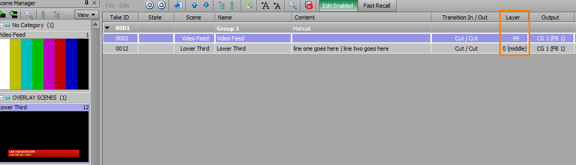

    The idea of a persistent scene is probably the simplest solution for you, which in the case with XPression, would be using layers. Set your clean 'video feed' take item to a layer below the default Layer 0 of your overlay take items. Layer -1 would work fine, but for safety you can choose a number like -99 to allow for additional layering of your other take items.
    That video feed take item will remain on layer -99 until another item is taken on the same layer or you choose to take that item offline. Overlay items on Layer 0 can be taken in and out without affecting the video feed.

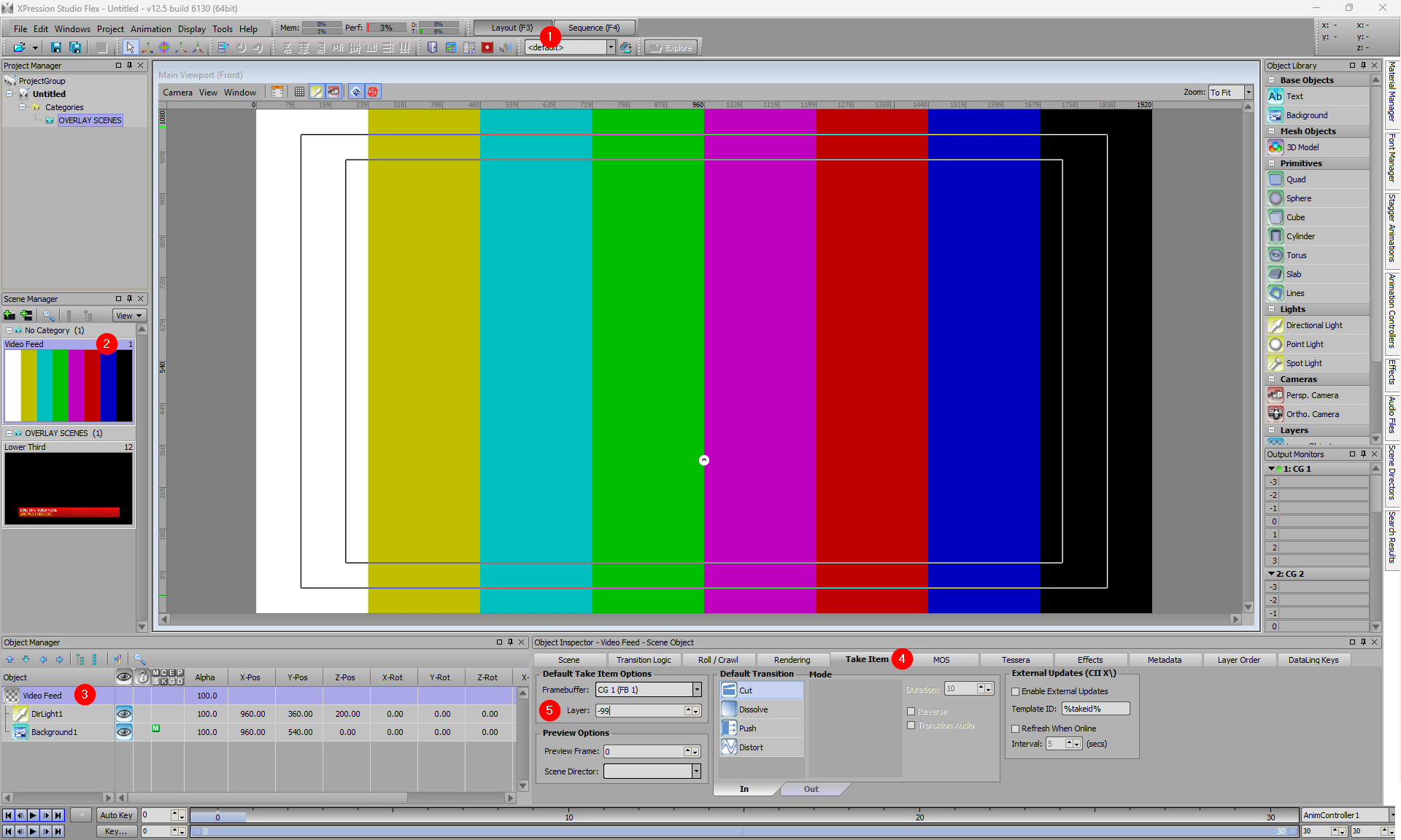

    You can do this by
    1. Going to Layout (F3)
    2. Selecting your video feed scene
    3. Clicking on the scene object in the Object Manager
    4. Going to the Take Item tab in the Object Inspector
    5. Setting the Default Take Item Layer
