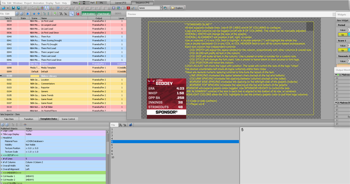

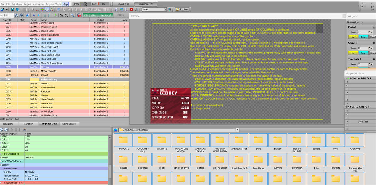

    Hey all, I know this may seem simple but I've been searching the forums for quite some time and I can't seem to find this. Is it possible to control Xpresssion dropdown lists in the data source tab (list box, and checkboxes).  I have a project where we can maneuver quite well through our project but can't for the life of me figure out a way to think of a script to either manipulate the list or check box for visibility.
    Let's say I have a slab and I jump to the "# of lines" tab. I'm looking to find out a way to either manipulate them with either adding one or taking one away based upon how many times I hit it. I didn't know if it was as simple as being able to having a way to input keyboard commands in a script.  I have multiple scene names so I didn't know if having to build the visual logic for them was a simpler solution or if writing a script would be better.
    I'd love to be able to have a script where I can either move up or down the list.
    And I'd love to be able to have a way to check visibility be on or not.
