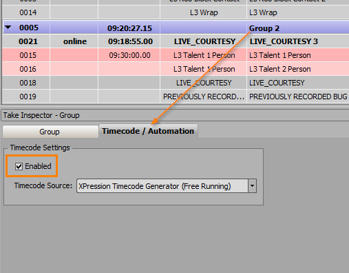

  • 2.  RE: Xpression: Timecode / Automation
    Posted 09-09-2025 10:23
    Did you also enable Timecode/Automation for the group? Take items in the group will not trigger unless that is Active.
    Jeff Mayer
  • 3.  RE: Xpression: Timecode / Automation
    Posted 09-10-2025 02:44
    That did it... Thanks Jeff.
    Somehow I didnt stumble on that in the manual :)
