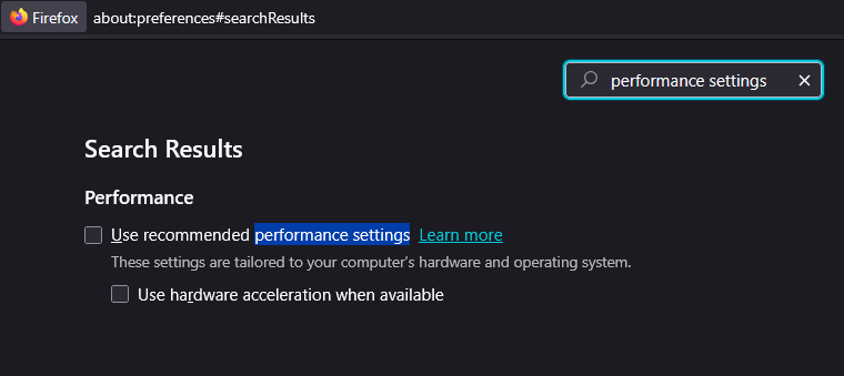

My colleagues finally could test it this way, and indeed, working with Firefox and the suggested settings, did the trick. Thanks! I hope you keep us informed around this and when we safely can use any browser we want...

It is an issue with all Chromium browsers in Windows 11 (and perhaps a windows update from the last few months), affects software other than XPression (OBS), current workaround is to use Firefox, as Jeff suggests.
