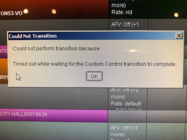

    I am trying to get Overdrive to play an animated transition using a custom control.
    It will key an animation over and advance the overdrive rundown using the function where i designate the custom control transition on the overdrive shot.
    My space bar currently runs the transition that is tied to the prepared shot - this works for everything other than my CC transitions.
    I have tried 2 ways to make the CC operate:
    #1
    Keys on DSK 4
    Plays the animation
    Keys of DSK 4
    #2
    Keys on DSK 4
    P[FONT=Calibri]lays the animation
    Overdrive Command - advance rundown
    Keys of DSK 4
    Each time when the space bar runs the CC transition attached to the shot - it has a time out error (picture included) and does not advance the overdrive rundown.
    The animation runs and the key cuts on and off though.
    Help!

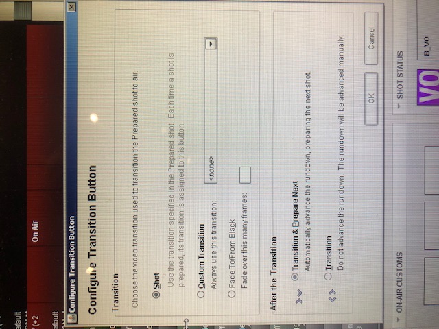

  • 3.  RE: Overdrive CC Transitions Timeout
    Posted 01-30-2019 12:50
    My guess is you need to change the Overdrive command to be a cut or auto transition on the switcher not an Overdrive command to transition.

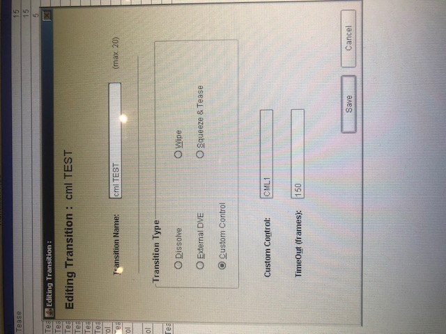

  • 4.  RE: Overdrive CC Transitions Timeout
    Posted 02-13-2019 11:36
    It seems like you need to increase the Timeout of the CC Transition. This is done in the Transition tab in Template Editor. Try increasing the time by 100.
    #OverDrive
  • 5.  RE: Overdrive CC Transitions Timeout
    Posted 02-13-2019 19:10
    We are on Version 15.8.7 of Overdrive on a Vision 3MLE switcher
    - I have tried replacing the Overdrive command to transition with a cut on the program MLE but it still doesnt advance the Overdrive rundown.
    -I have tried increasing the CC timeout - the CC runs through and then everything sits for a while and then it comes up with the timeout error box still
    #OverDrive
