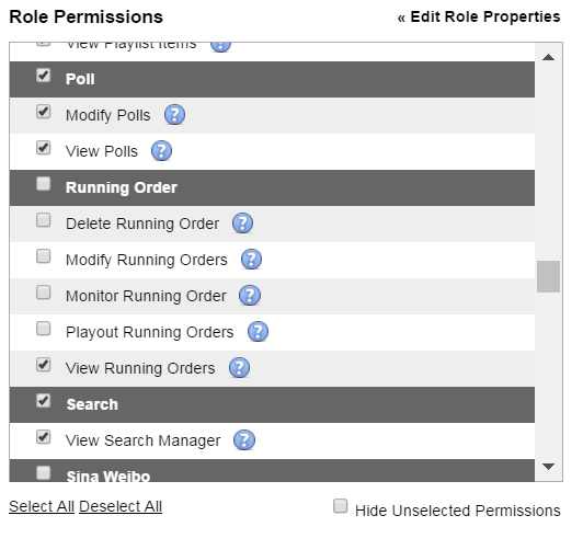

    One of our student producers accidentally deleted an entire show 30 minutes before air. For future reference, is there a way to recover these deleted show run downs?

    There is a user permission that can prevent this in the future. If you look in the configuration menu under Manage Roles and Permissions, in the Running Order section there is a permission for Delete Running Order. Only users with this permission will have the ability to delete running orders. There is also a pop up dialog box that asks a user to confirm if they actually want to delete the running order.
    There is currently no way to recover the content. This is an improvement on our roadmap.
