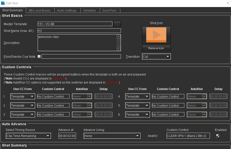

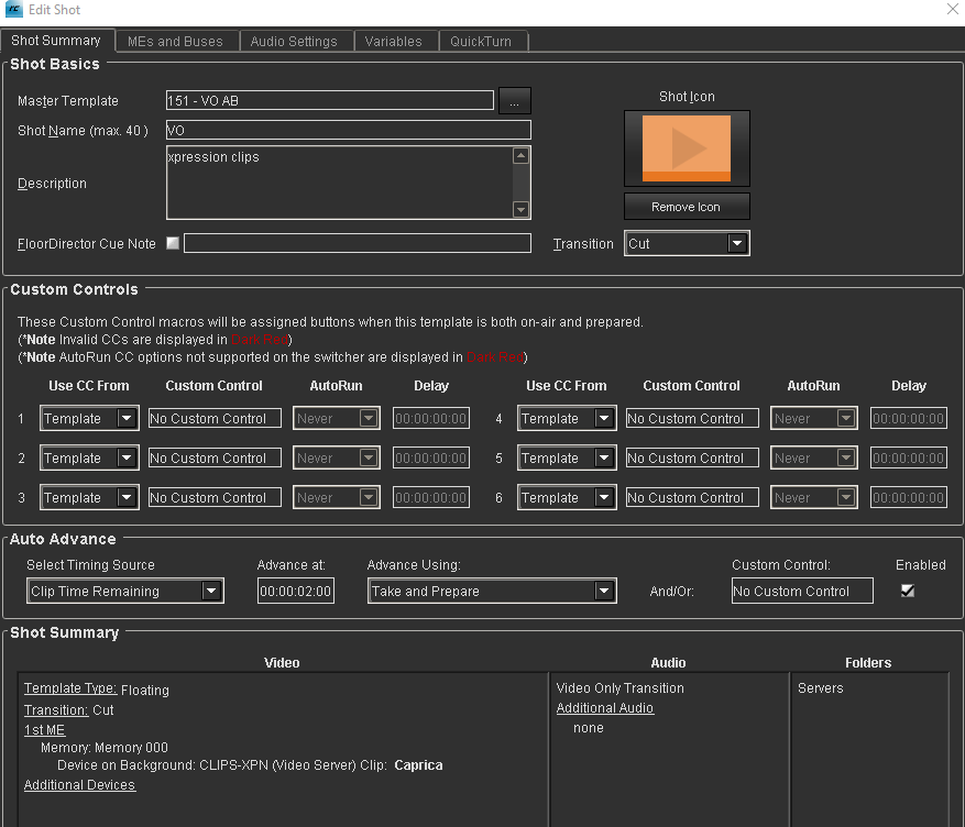

    You can use the auto-advance to automatically advance to the next shot in your rundown, by using a timing source.
    One good example for auto-advance: I have a video server element, I can configure auto-advance to automatically take the next event when there is 2 seconds left to the video. (See the "autoadvanceexample" image for the configuration).
    Another good use, could be to trigger automatically a CC when there is 5 seconds left. Maybe to remove the Graphics, or to open the microphone. For those examples, you would use Custom Controls (see the "autoadvanceexample2").
