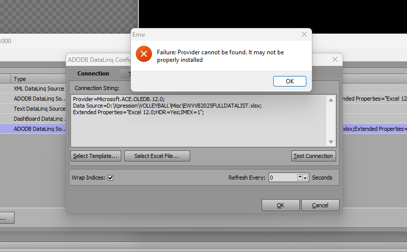

    I'm trying to connect an Excel file to my application using an ADODB DataLinq connection, but when I test the connection I get the error: "Failure: Provider cannot be found. It may not be properly installed."

    Do you have excel installed on that machine?

    yes i have already.

    try this thread, I have linked the drivers in it.
    https://rossvideo.community/discussion/datalinq-excel-error#bm488ef71a-531b-4889-bd72-018ef687ee2c

    I'm a little confused. Do I need to install the whole system (Xpression)? I already uninstalled all my software and reinstalled the 32‑bit version (Xpression Designer), but I still get the same problem.
    Could Kaspersky Antivirus cause this type of problem?

    Did you click the second link?
    It's a 32bit driver for excel.

    sorry simon, i will try this one...

    THAKYOU, SIMON REDMILE.. Its Worked for me. 😀💯
