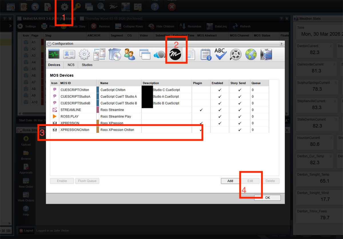

    Step 1: Click the configuration cog at the top of the interface.
    Step 2: When the configuration menu opens, click the Black "M" circle. That will open the MOS devices.
    Step 3: Select your MOS device. In my case it is for XPression.
    Step 4: Click "Edit"

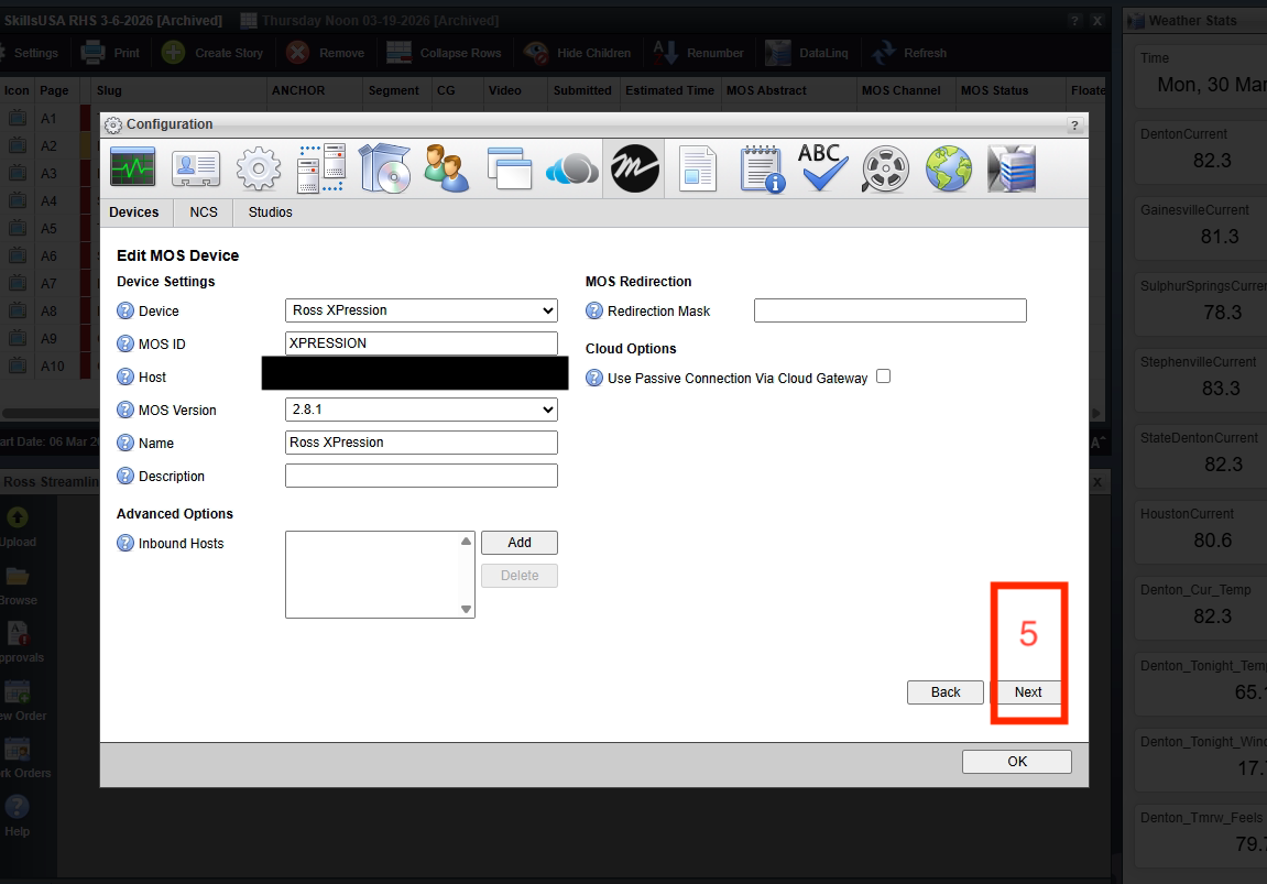

    Step 5: Click "Next" (Yours may or may not have more pages to click through)

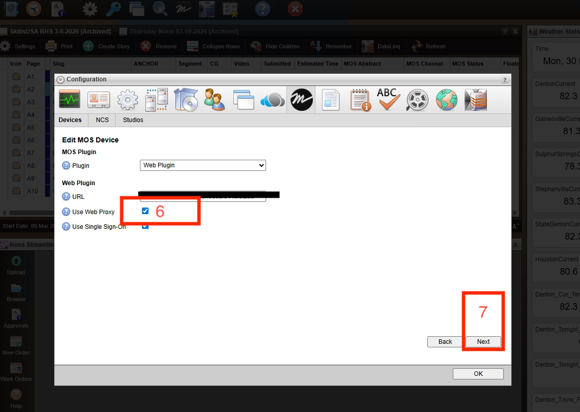

    Step 6: On the page that says "Web Plugin" there should be a check box for "Use Web Proxy" you can check that to enable it.
    Step 7: Click "Next" until you get to a page that says "Save" then once saved it should be set properly.
