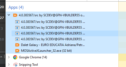

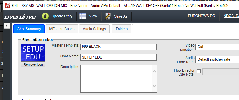

I am encountering a small bug when I'm trying to edit Ross elements inside Dalet. When I double click an element it opens a pop up window that appears as a MOSActiveLauncher in Windows Task Manager.
The problem is that when I close the said window, the plug in remains open in Task Manager and when I double click a different Ross element in Dalet, it actually opens the previous one. And I can see in the pop up window that the name of the window and the name of the actual Ross element are different.
The solution is to open task manager and manually force close the plugin every time I edit an element. Is there a different solution to this problem? Maybe an update of the plugin?
