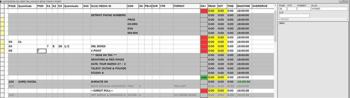

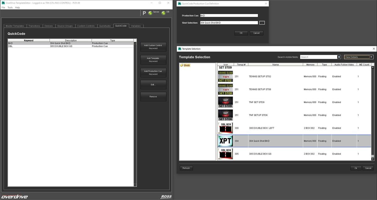

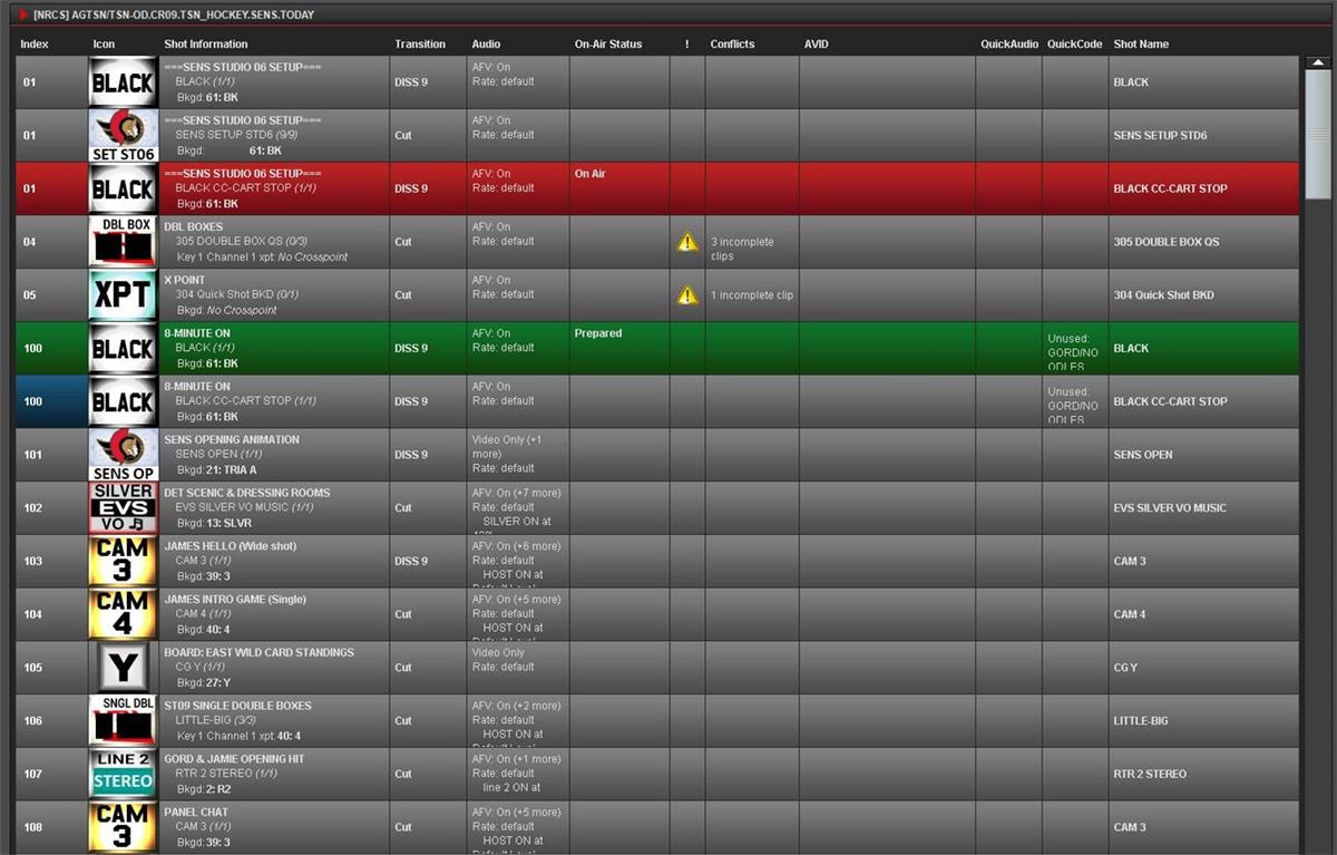

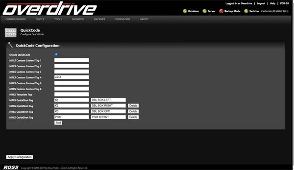

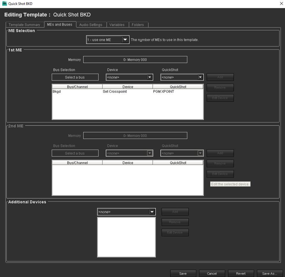

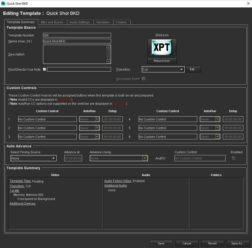

    Hey all, I am trying to get the QuickShot to work for me, I am close but not quite there.  I can get my Production Cue Keyword to call up correct Template in the RundownControl, but the number in my "PGM" column does not insert the Crosspoint. I have attached photos to follow along in my steps to see if anyone can see where I went wrong.

    QC RundownControl showing that the Crosspoint is not populating properly

    I am not sure if you were able to find the issue, but one thing you can check is if the "PGM" column in your NRCS is published from iNews in the MOS messages.
